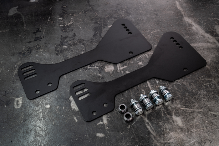

    If it's a side mounted seat, it will need brackets: https://www.garagistic.com/collectio...mount-brackets
    If you want a bolt-on solution, you may need adapters to mount the sliders to the car, like: https://www.garagistic.com/products/...g-seat-bracket
    Another option is to reuse your stock sliders with something like this:
    E30 Bucket Seat Side Mount Brackets for OEM Sliders Product Description Introducing the Garagistic side mount brackets for racing seats! These precision-cut side brackets will allow you to mount the bucket/racing seat of your choice in your car. These seat brackets come equipped with 6 vertical mounting holes for the
    Sorry for them all being garagasitic links. Plenty of others make this stuff too.
