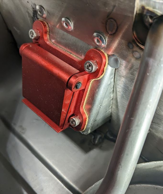

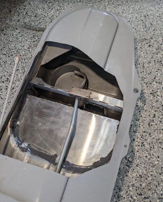

    So, I engineered my current solution which I have now tested for several events and I can say it works!

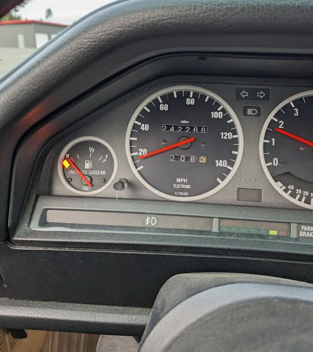

    The goal was not to have extra plumbing with a swirl pot or additional fuel pumps as points of failure. This project involved cutting the tank open, adding baffles and a trap door, and sealing it back up. Pressure tested, naturally. In my testing fuel is kept at the pump down to 1 gallon with 1G left and right turns. I've run it on track well below the fuel low light on several occasions now without issue.
    The only downsides I've encountered is that the fuel level will read slightly high during hard maneuvering as the fuel is concentrated in the pump section (but during straight and level driving there's a bleed passage that equalizes everything and it reads normal). Second, the tank takes a bit longer to fill. It won't fill at full pump volume without triggering the auto-shutoff. I think making the baffles about an inch lower would totally solve that, or I might have a venting issue. I don't completely understand it yet because the vertical baffle isn't any higher than the saddle, and that doesn't limit fueling flow..

      The trap door came with a gasket. For all of the gaps I used the same stuff we use to seal commercial aviation (and military...) fuel tanks. Flamemaster Chemseal 6 Oz Cs3204 B1/2 By Aircraft Spruce, a polysulfide two-part sealant.
      I threw-up a video of an early test on the first tank to show it working. You can see the equalization bleed through at the end. https://www.youtube.com/shorts/CuFdCJTrNgI in my first iteration the trap door wasn't canted, it doesn't work as well vertical but when it's canted gravity helps keep the door sealed (it has a rubber O-ring seal, super nice!)

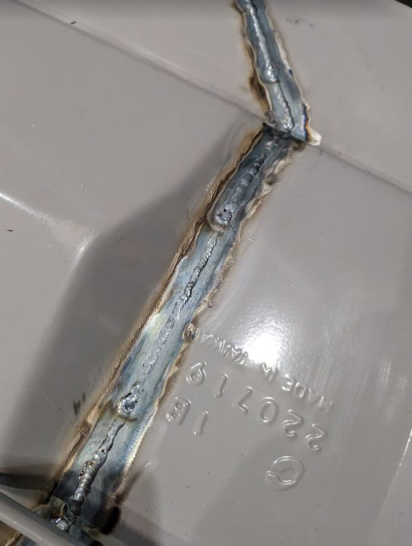

        Did you end up welding the tank back closed?
        Any tips on welding a tank that's previously had gas inside?

          I welded both of them closed. Honestly, once it's been open like that for a few days and it's been wiped-out there's *zero* residual vapor and you can't even smell it, let alone create an explosive environment. It's worth it to just get a new tank for all of $275, too.
          I opened the tank with "thin-cut" dremel blades which are 1/32" thick so there wasn't much gap to fill. For pressure testing I made some fittings to seal everything up and kept pressure below 1psi.
