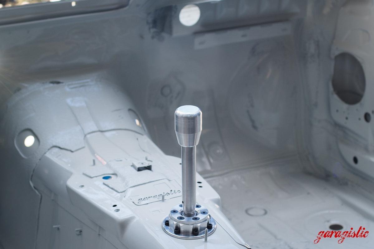

            I use the Chassis Mounted shifter from Garagistics. I know that you are using some parts from them. They over a few options, but I'm using the one below (medium height, Black, Knurled knob).
            GARAGISTIC SOLID CHASSIS MOUNTED SHORT SHIFTER Description Are you looking for the ultimate in precision shifting and feel? Want to eliminate all slop in the shifter for that tactile, mechanical feel and satisfying shift? Look no further than the Garagistic Solid Chassis Mounted Short Shifter! The Garagistic Solid Shor

              Those both are good options. I still have not done anything yet. The idea of high effort on the street is a no go so thanks for that advice as I will only get to the track 5 times a year.
              Its Soda not Pop, what are your driving impressions with that shifter? notchy? super tight spacing?
              • It's Soda Not Pop
                • Jan 2022
                • 877
                It's way more direct with zero sloppiness. The height setup that I have makes the effort very minimal.
