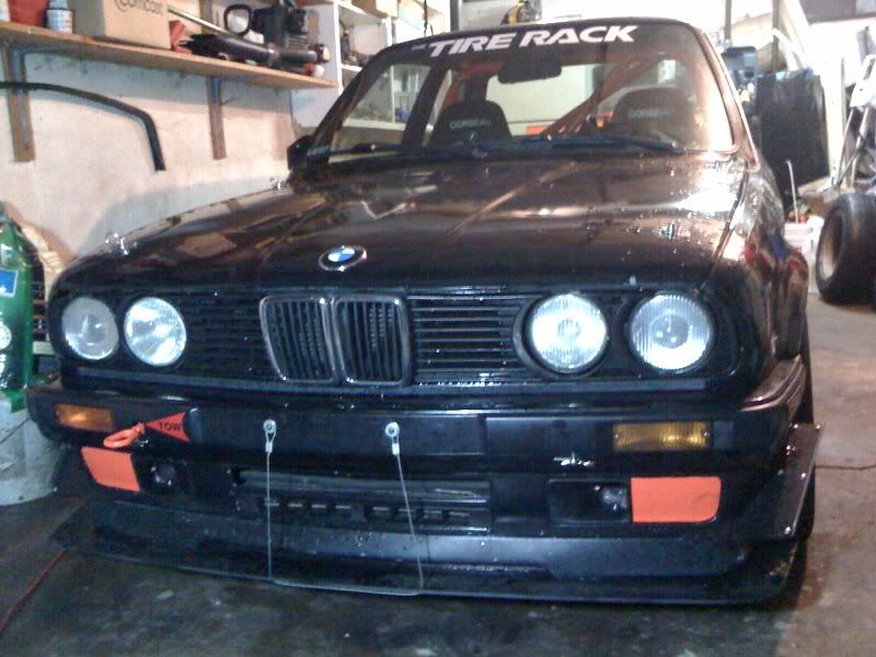

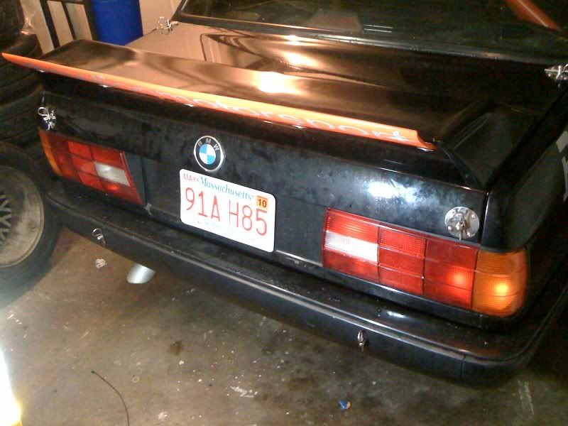

    Hey guys,
    Is there anything wrong with pinning on bumper cover skins? I took the bumper support out and used some hood pins and pinned it to the bumper cover. The pins only stick about 2cm out.

              I like your splitter below the IS lippe, i was thinking of doing that too! haha

                the skins are sooooooooooooooo light by themselves.... plus its much more free than fiberglass...... the splitter is attached to an IS lip :)

                    mine just slide right in the OEM tracks that hold the bumpers in from factory.... i gave it a couple kicks and a hockey check and they didnt seem to move at all.

                      Can you take a pic for us of what your setup looks like with the bumper off, how the pin is held together?

                          the weight savings is pretty hefty ... since the fiberglass support was taken out and the metal brackets.... i didnt weigh it but i would say its about 40lbs front and back... all i did to mount the pin is weld on a nut to the metal support that goes into the frame put the pin in and lock it down with another nut... put grease on the end to mark the spot on the bumper... drill and pin... i zip tied the front lights in for home to street transportation.
