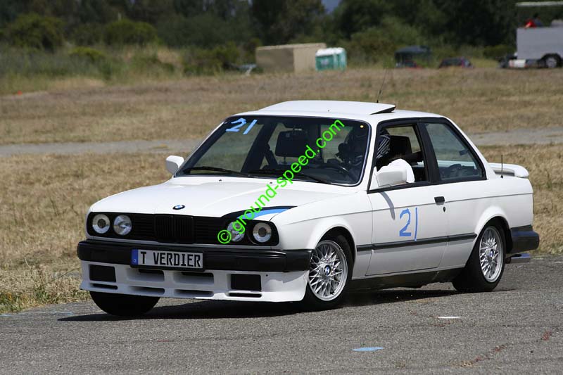

                    i have tons of body roll and a lot of understeer so i bought sways.
                    i think that will make way more of a difference than camber plates. but i have no experiance with a car that has camber plates just sways.
                    if your car looks like this than the answer is clear.
                        I don't think body roll is as a big of a problem as you suggest. Camber plates significantly change the tire contact patch, especially on r-comps. I went from wearing down the outside 1-2" of tire to cords in 2-3 events, to using the whole width of the tire evenly and getting more life out of my tires (4-5 events). I also gained about a second on Pocono North (1:05's to low 1:04's, and even some 1:03's).
                        From what I understand, sway bars shouldn't really be used to control body roll, that's a function of springs. Swaybars should be used to control oversteer/understeer. If you set your car up using big sways and soft springs, and then you want to dail in oversteer/understeer, you have one fewer tuning tool now.
