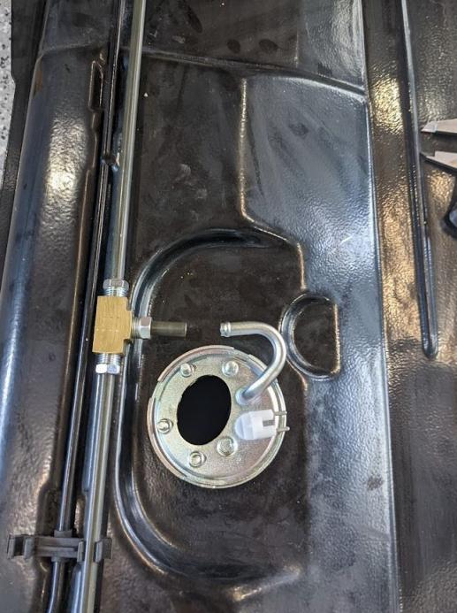

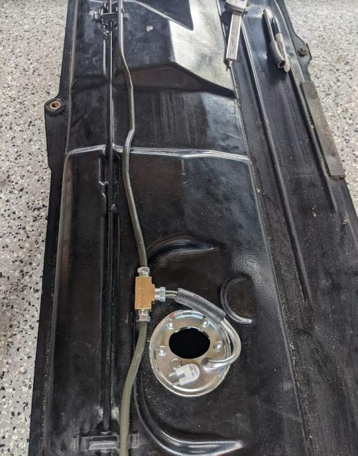

                    Here's where I stand.
                    I have a stunt-double fuel tank (it's actually in good shape and hasn't been used to jack-up the car...)
                    I have an extra fuel pump hangar.
                    I sourced some 5/16 polymer coated steel brake line at NAPA, as well as the proper inverted flare tee (amazingly cheap!)
                    I have a good idea of how the pump and lines will sit, but the clearance on the drivers side access is minimal. I think I can grind out the opening a bit to clearance the pump pipe, but the black cover plate will still be sitting on top of it. I will probably also weld a modified cover plate that has an extra inch of clearance. That pipe sits about 1" up and the access cover plate get pretty tight to the tank towards the back.
                    Do I need to bend the line into the intricate shape of the stock line??
                    Suggestions welcome...

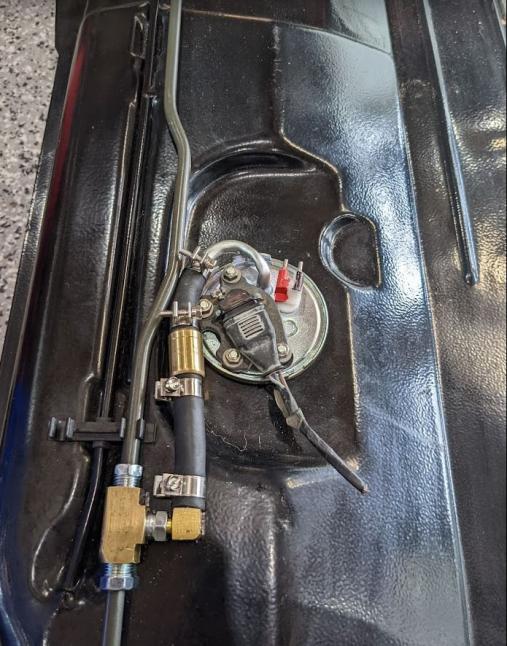

                      That hardline if pliable enough to bend closer so it will stay within the confines of the access panel. Now I need to get an additional sender and modify the hanger for a DW200 pump, plus order the hydramat.
                      An important question: is anyone running Hydramat with a turbine (non-positive displacement) pump?
                      Edit: I did some experimenting and verified that the turbine pump may work...
                      However, that was with the extra vent hole on the bottom plugged, otherwise it sucked air through that and stopped pumping.
                      Click image for larger version  Name:	Capture.jpg Views:	0 Size:	65.6 KB ID:	10055131

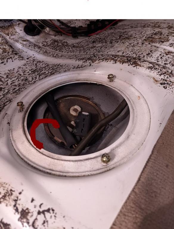

                          Here's my final interpretation of the requirement. It's a Walbro GSS430 pump and a Holley 3x8 Hydromat sock. I have the level sender insulated from the body by enlarging the inlet with a die grinder by a few mm and up-sizing the O-ring a bit. The studs have heat shrink over them, plus a fiber washer on the bottom and nylon on top. Resistance between the sender and the tank is 1 megaohm.
                          I'll very likely have this pump on a separate switch for "track mode".
