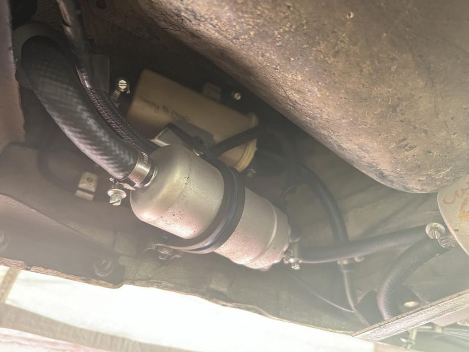

            • bradmer
              • May 2016
              • 362
              #96
              Originally posted by hoveringuy
              Pictures, P/N's, details?
              I purchased the 2nd one from ForcedFirebird (Thank you!) , the first one is plumbed exactly as he laid out above. It is small like a flask so it can be placed up in this space with some effort.

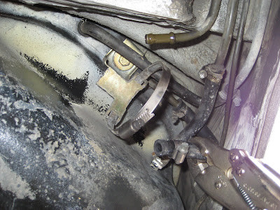

              • hoveringuy
                • Dec 2005
                • 2722
                #97
                I have a late tank, so my hole looks more like this. I could certainly fit a reservoir there, particularly if I fabricated it so the connections were orientated to my advantage. Put the fuel pump up front?

                • ForcedFirebird
                  • Feb 2007
                  • 8300
                  #98
                  Thanks, that's basically a plastic version of what you showed earlier.
                  I would like to see how it slots into the e30 fuel filter area, the one you had on the e36 looks like it was up front.
                  The e36 has the fuel filter on the frame rail, so I just utilized that space. Yes, I make them out of aluminum, then pressure test them. I have a pic somewhere of the ls1 swapped w211 race car we did. MB used a lift pump and it would starve at 1/2 tank - which was mounted vertical behind the rear seat back.
                  You're welcome. Thought it was you who bought it. I had a few of them and one was laying around forever in my upper cabinet over my office desk. Think it was in there for like 5yr? lol. They are available again, but they are now +$200!
                  You can. On the e30 race cars, I use the "battery tray" to mount the fuel filter, you could easily put a pump there. One of the other guys in my group made a small tank and put it in the battery tray and strapped the pump to it.

                    • hoveringuy
                      • Dec 2005
                      • 2722
                      #100
                      Originally posted by redneckvtek
                      Early cars had the fuel filter mounted vertically in the engine compartment under the master cylinder. I use this fitment/placement for the fuel filter to get it out of the fuel tank area.
                      I can certainly put a tank where my stock fuel filter is, and I can move the filter to the engine bay, but I don't have room for the pump with the tank where my filter sits unless it's really small. I think the pump needs to be co-located with the tank which limits my options. Not crazy about putting the tank in the trunk.
                      • ForcedFirebird
                        • Feb 2007
                        • 8300
                        #101
                        Surge tank and pump don't need to be close. You could put the surge tank under the car where the filter goes, and the filter in the frame rail like an early model. Both would actually fit up front like I did in the e36 posted above (my buddies e30 is like that too).
