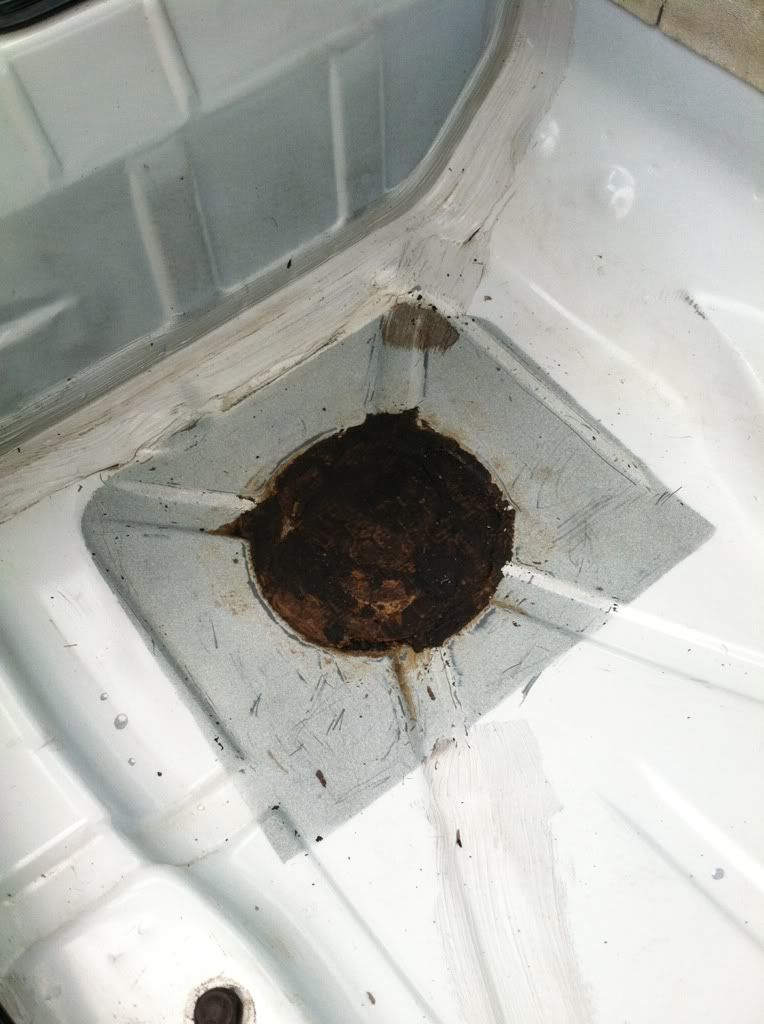

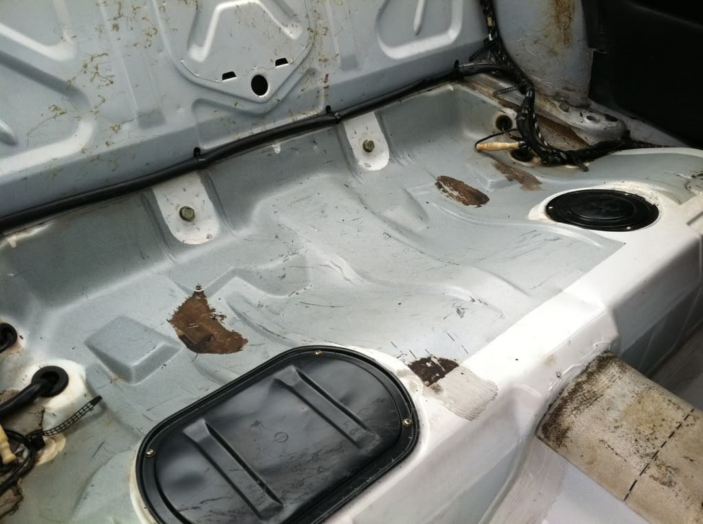

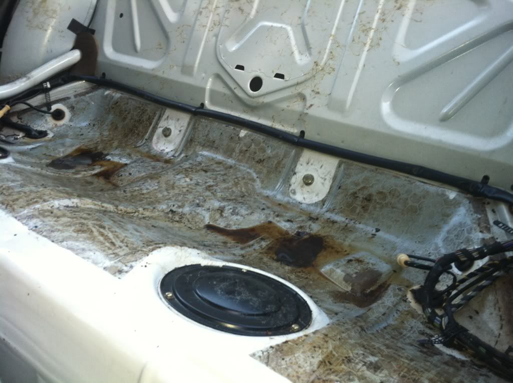

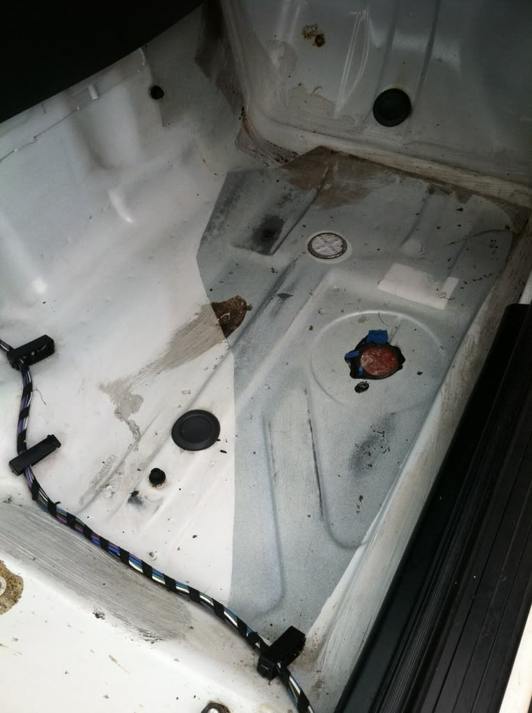

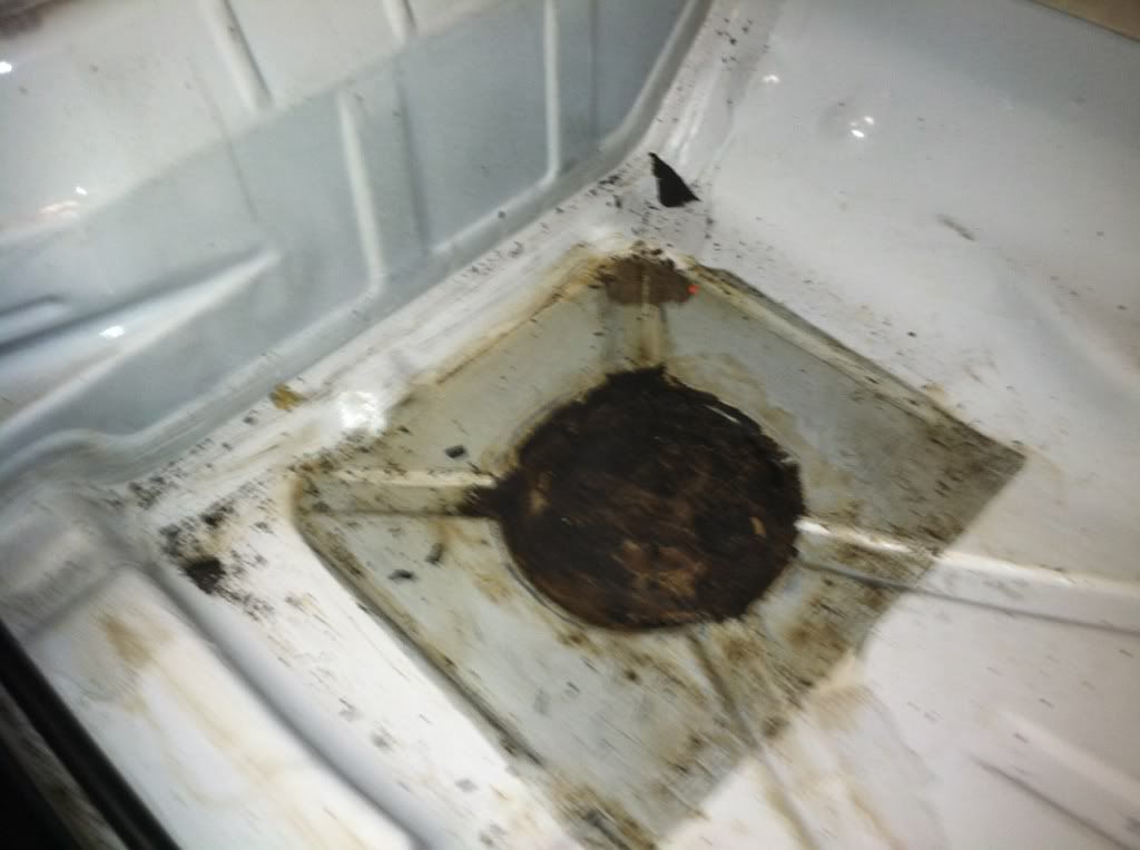

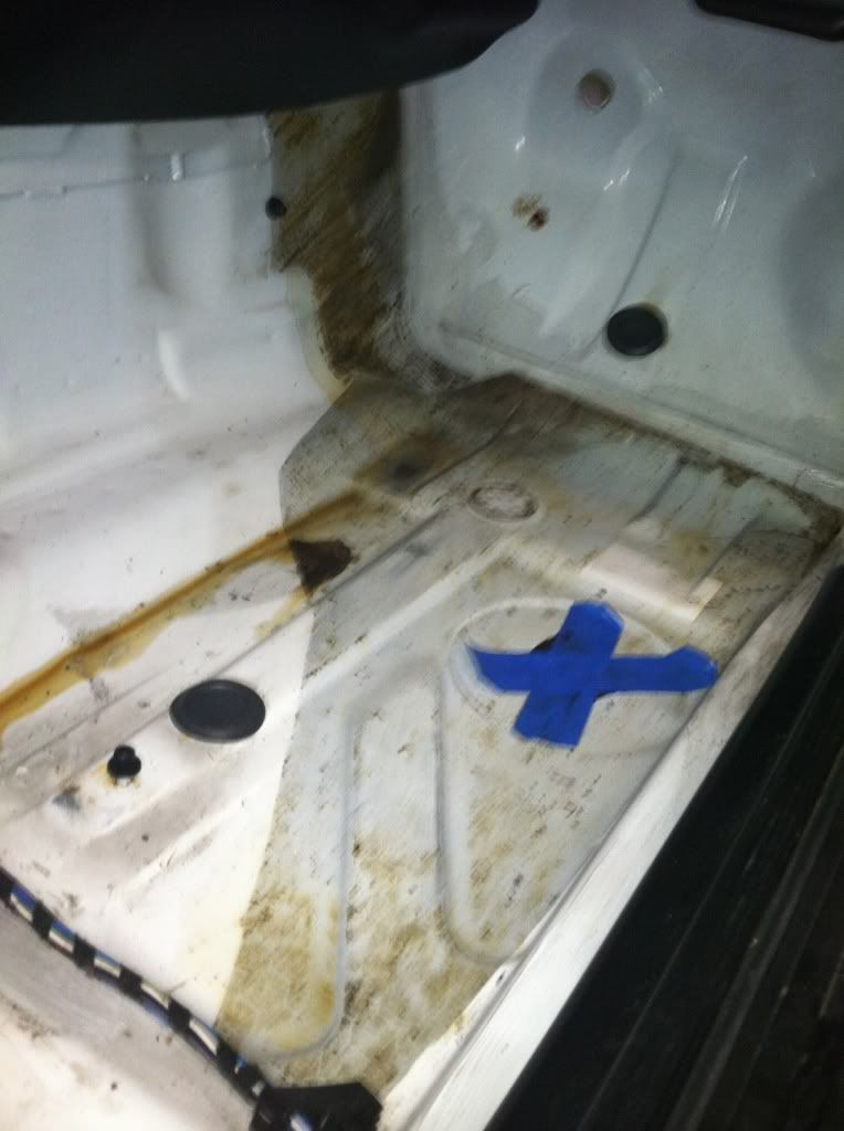

    hello guys,
    I took the sound deadening out and was in the process of removing the residue, i gave wd-40 a try and it worked great.
    just wanted to share the tip with others.
    Just spray it on let it sit. Wipe off 5 min later.
    before
    after
    before
    After
    before
    after

    Damn,that worked great..I've used the 3M adhesive remover before,but thanks,I will try that

      Awesome man, I'm in the same stage as you right now, been using lacquer thinner and just doing small sections at a time. Wd40 should be much more tolerable, gonna try it right now!

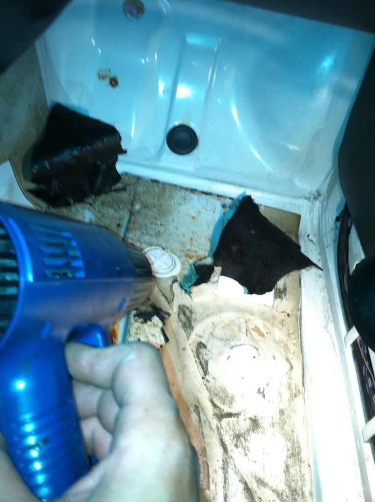

            procedure 2
            • use heat gun on the sound deadening
            • then pry it up with a putty knife
            heat gun in action

              Psssh Alex just man up and delete some brain cells, use gas.
              But in all seriousness I wish I would have known this when I did mine. The heat gun worked better than the compressed air upside down for me.

                        Worked perfectly. Got mine out and it's all nice and white.
