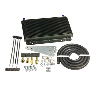

      unevolved, can you recommend a shop that does this? If there's one thing I'm terrible at, it's finding a place to do something for me. I tried for a few weeks to find a mythical "machine shop" to drill and tap something for me, ended up just buying the tap.
      Can anyone comment on the quality of rubber hoses clamped to barbs for an oil cooler?
      namely this system (I realize I'll have to find m22 barbs for the engine side)

            barb fittings work just as well as AN fittings, they just dont look as sexy. If you go this route make sure you get good oil hose that wont break down after a while.

                Yep, barbed fittings will work just fine if they're the appropriate size. If they're sized right, you can't hardly pull the hose off, even if there's no clamp.
                I've gotten some stuff made by Hufco off Hempstead Hwy, and they've worked fine. I haven't really shopped around, though, so I can't say how their prices compare.

                          As for an oil cooler, right now I don't have an oil cooler, so if I were to upgrade, it would probably cost me a lot more than $50 because of the lines required. Is it worth the cost?
                          Definitely. A good oil cooler will make a huge difference in oil temps. Lower oil temp not only takes some thermal load off the cooling system, but also helps prevent the oil from breaking down. If you're using oil to cool your turbo (like old Porsches), the difference is even bigger.
                          oil cooler is worth the money .. It dropped my oil temps 20 degrees on the track in my NA s52 car which equates to lower coolant temps
                          Agree 100%.
                          Originally posted by saturnv7890
                          And is there anything cheaper than -AN that will still work effectively?
                          Just check the Yellow Pages for a shop that specializes in hydraulic lines. Example: http://www.yellowpages.com/houston-t...ic-hose-repair

                              I prefer a cooler with AN fittings. To plumb the cooler I have a hose shop make up new lines that have the OE fittings on the engine ends and AN fittings on the cooler ends.
