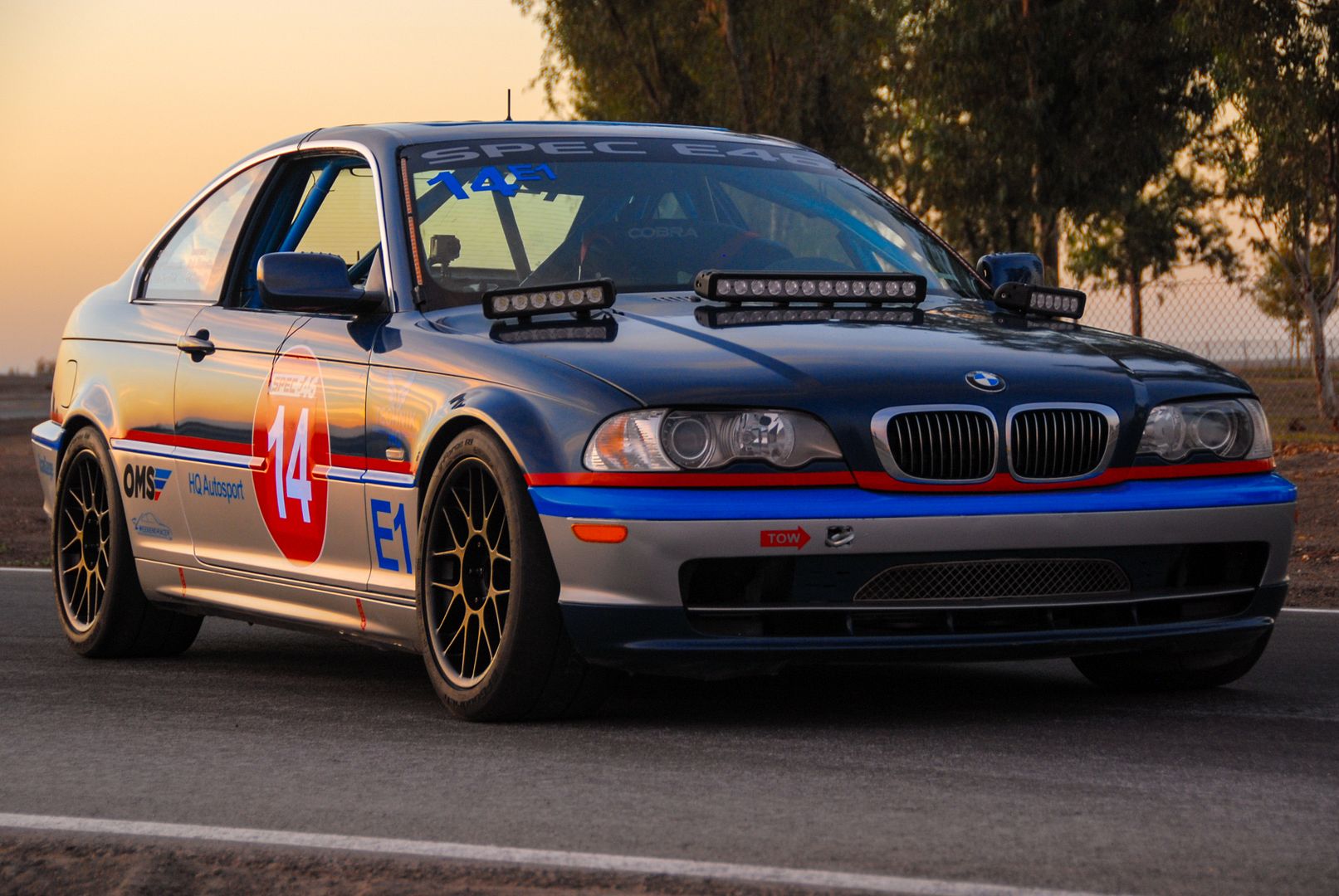

                                I just put the flat on my Spec E46 and I am partial to them.
