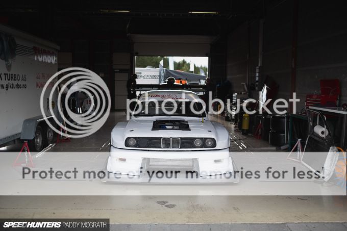

              #36
              Have to post this pic I saw on SpeedHunters from the Gatebil event. Major aero action going on!

                #37
                Very cool! Did you happen to see any specs on that thing? I wana read the build sheet
                • Jb325is
                  • 2137
                  #38
                  It looks like most of these are just bolted to the bottom of a lip valence and subframe or skid plate in the rear? No adjustability? If I were to do a splitter on an e30, I would build it from alumalite and bolt it to a small 1" square tube frame that bolted to the frame rails with slots to allow some adjustment... I am definitely nowhere near the point of wanting or needing aero, and I think a lot of people go there before properly setting up their car or learning how to drive it.

                    • Reub_e30
                      • Apr 2016
                      • 145
                      #40
                      Couldnt find anything. There was only one random pic
