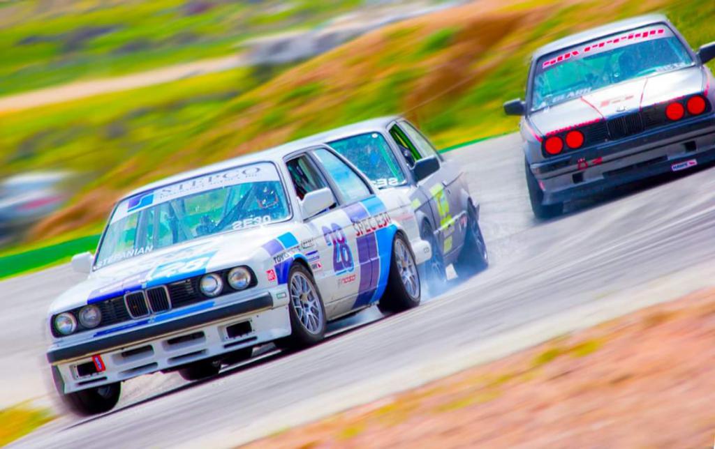

Rears are pretty good as is. It used to rub a bit on the inside with the taller Conti's but I *think* we're good with the Dunlops. We'll take some 5mm spacers with us next weekend just in case
No they're DOT-R fenders that came with my friend's M3 as spares, or something. Car is currently running 17x9 ET30 Apex ARC8, but with 12mm 5 lug sleeve and 10mm spacer to clear strut, so 17x9 ET~8 and 235/40 Z2 Star spec. I cut off and filled the corners in the fender wells (battery tray and behind headlights) for clearance as well. I rubbed a bit with the Conti ST slicks, but doesn't seem to at all with the 235/40 Z2's
Looks great, i'd love to see what you did in the rear fender walls. That's where mine rubbed. Or used to rub...
