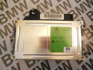

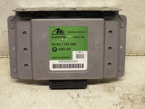

          I need to find out some more about the 3-line ABS only system (referred to as ABS-ES on the ECU and in the part system) as I have a feeling this relies wholly on the master cylinder sizing for bias and the car does not attempt to change this or alter it based on braking conditions

            for future reference, ABS-ES (pre '95 abs only system) controls brake pressure proportioning to the rear only. This means pressure in to the rear circuit is reduced by a fixed percentage, front always receives 100% - they're equal to around 25bar (ie rear brakes receive 100% of the rear line pressure) then a reduction of around 30% is applied to the rear only - its not a bias of % (front vs rear) modification. This is a "fixed proportioning valve" ie the point at which proportioning takes place is fixed at 25bar as is the %
            from what I can find you should not fit a proportioning valve after the ABS unit - its possible, but this is like fitting two proportioning valves in series, and you end up with double-proportioning.. eg if you set the second valve at 50bar and 80% proportioning

                            I have a feeling the "abs only" (labelled ABS-ES on the ECU) 3 line system fitted pre-1995 was the same on the Euro M3 and 325i as their US equivalents, but i'm not 100% positive on this so you may need to do some research on realoem or similar to check part numbers - everywhere I've read about it its referred to as Euro M3 but unsure if its because US M3's has ABS+ASC or something as standard across the board?
                            Either way, what you need is a 3-line pump as below..
                            ..which has 5 ports - 2x in from m/c (top left in photo) and 3x out (bottom in photo, for fl / fr / rear). You also need to know the german words for front, rear, left and right to plumb it in!
                            The correct ABS ecu looks like this..
                            ..there is another version of this which looks exactly the same but doesn't have the cooling fins on the side - this is the same part number and works fine; not sure what its from (mabe an e38 or something?)
                            There's another "green label ECU" which looks like this..
                            ..and that is no good! its for the 318 I think which has a different system and can not be remapped. It may also be the same one used in the e30? Im not sure..
                            I have heard any 3 line pump will work fine, however I can not confirm this and as the parts are cheap and readily available it makes sense to get the "right parts" which are..
                            34521138219 - ECU
                            34511162291 - Pump
                            ..there's also another pump which I think ends '94 which I know works too, however it doesn't show up in realOEM at all. This is a more common pump and much easier to find, which makes me think this is the original factory fit pump which was no serviced, and the '91 pump is the field service/replacement unit (hence rarer and harder to locate)
                            In terms of fitting it to other cars, this system of the "euro m3" pump and ecu can be run as a standalone and fitted to a multitude of other vehicles - I've found reference to people using this in e30's, e46's, even e90 touring cars in Europe, inplace of the very expensive bosch motorsport abs systems. I've also seen threads where people have fitted it to things like TVR's, Ultima's and Nobles and other high performance kit cars / production which didn't have factory ABS
                            The wiring information is in the early e36 electrical troubleshooting manuals, and basically it requires power/ground/ignition, wheel speed sensor inputs, and some additional wires if you want to connect it to the diagnostic connector, abs light on the dash, etc.. I can't comment on compatibility with e30's, but I think I read somewhere that the e30 has the same number of "teeth" on the wheel speed sensor rings as the e36, so it might be fine, or work with just a swap of the sensors..
                            The 4-line e36 and e46 system can be adapted, however I think there's much more interaction between ECU and DME so that's a more complicated to do and I'm not sure there's a massive benefit vs. a remapped 3-line system.. I also don't think the 4-line system can be remapped, however that's just based on me not finding anyone who can do it during my research
