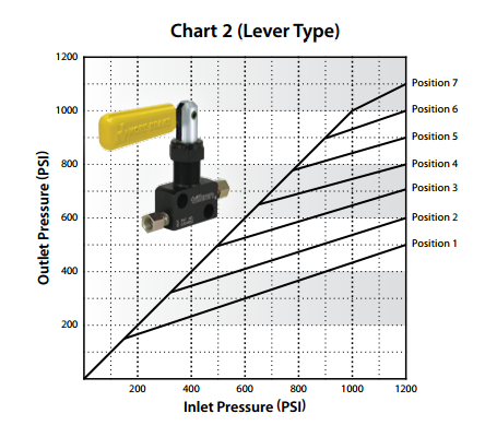

                As a very short technical note. If using OEM calipers and swapping the original differential bore MC, I strongly suggest to remove the OEM bias valve which is a pressure limiter. Otherwise the rear brakes will be very lazy on high pedal pressures, putting more than needed work on the front brakes and making the car unstable on hard braking. Here's the (probably) 10 years old graph that show what that valve does.
                1 bar is roughly 15 psi
                You can replace it by an adjustable one. But never put both in line. ;-)
