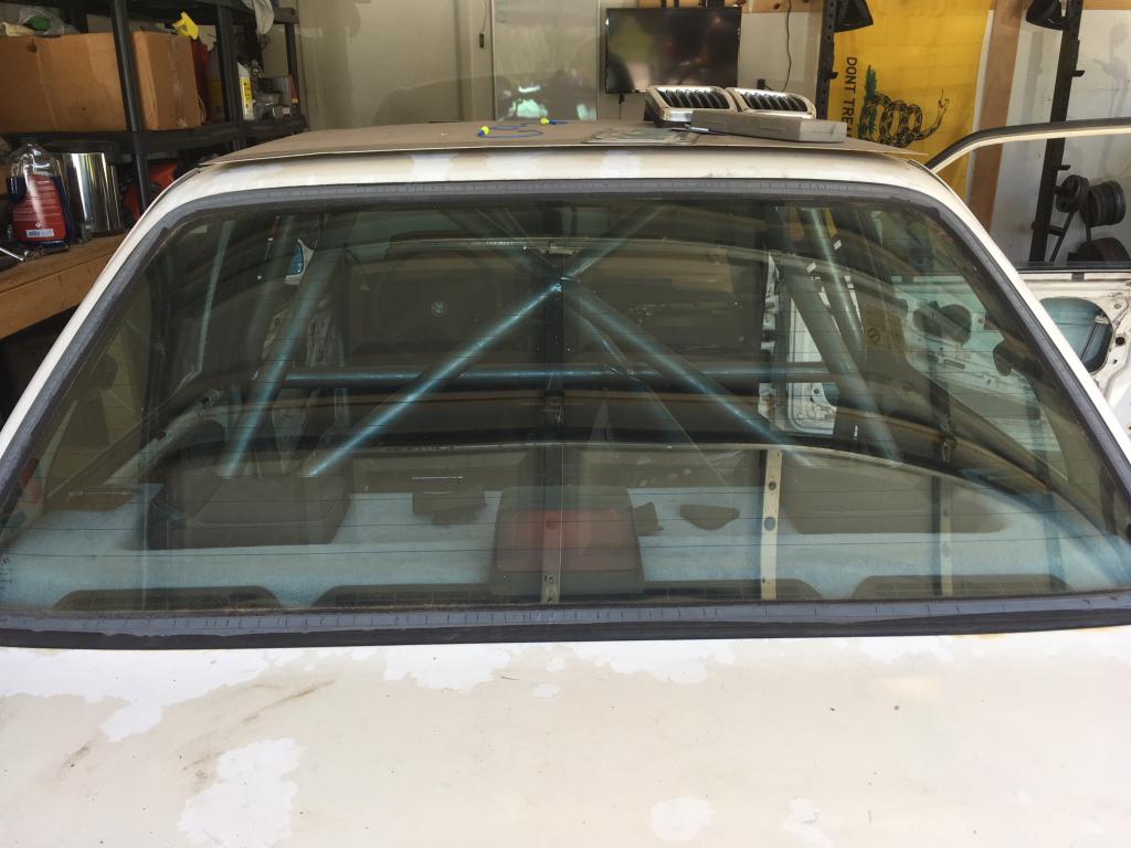

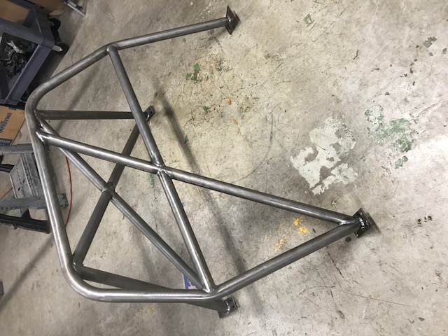

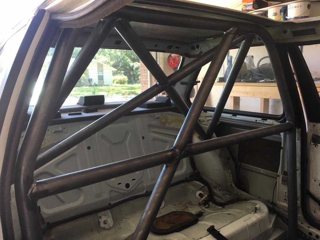

    Just in case anyone is interested in another option, I just had a guy build me a bar that I think looks to be better quality then anything else I have seen so far for a bolt in bar. Pic attached for reference. The fitment to me is spot on and at the best mounting points you could get for a bolt in bar.

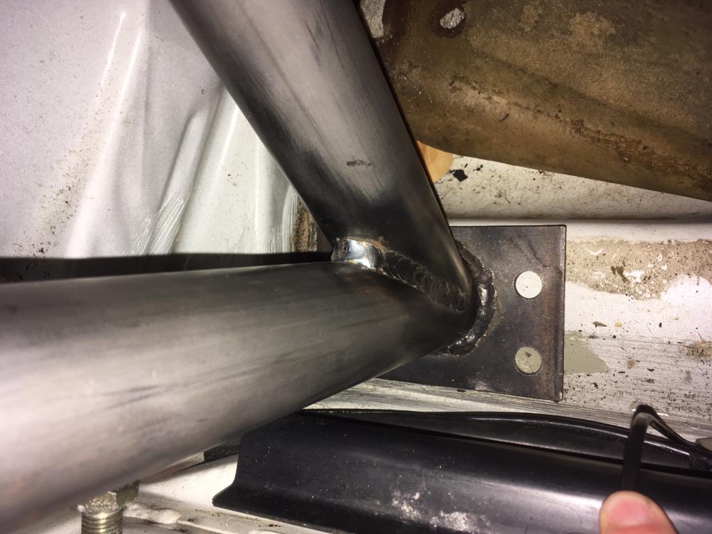

          Those base pads look very small- what do they attach to?

            They probably bolt to the rocker edge, which is only about 2"-3 wide. They look like they are much longer than they are wide.

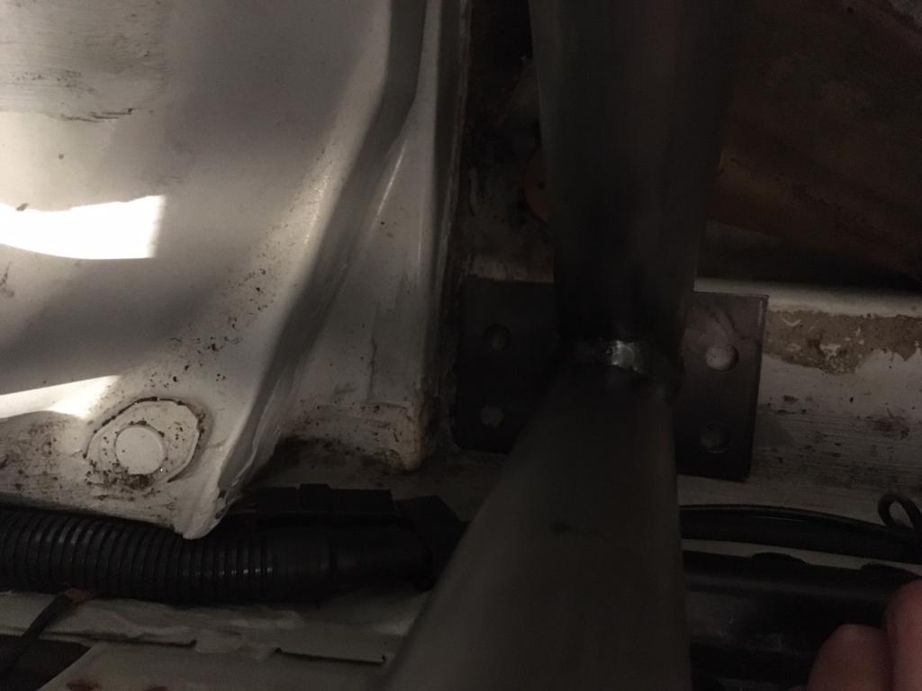

              They bolt on the rocker edge with backing plates. They are in fact longer then they are wide. I believe the rocker area is a stronger mounting point then further inbound on the floor, but I could be wrong.

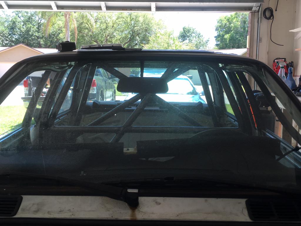

              Haven't finished my install yet as I want to paint my bar and clean up some interior pieces still, but I am very excited for the bar to be completely done.

                Wow, that's an impressive fit!
                When you drill the bolt holes, you'll get a good sense of how
                much meat they're attaching to. If it's only one layer, I'd be
                backing the pads up with a bigger plate, but if you get significant thickness,
                a good backing plate underneath and off you go.

                  You'll probably have to remove the fuel lines when drilling the driver's side. I don't know if this is really within the scope of a bolt in bar, but with my custom 4pt weld in bar they made big plates that bend over the rocker curve, and carry onto the floor pan as well.
