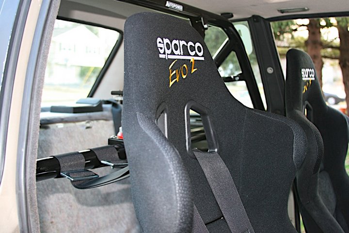

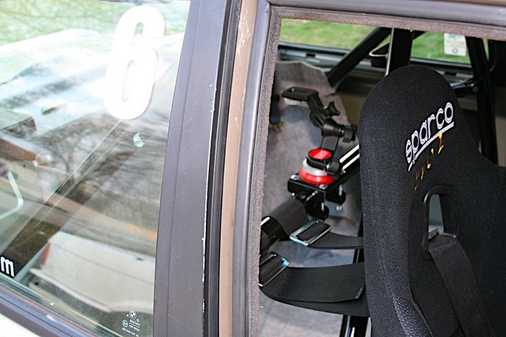

                      for hpde, esp if you plan to drive the car to the track, a cage is overkill. get your maintenance upto snuff, bolt in rollcage, seats, 5/6 pt harness, helmet/hans and your good to go. don't overthink it, just go do it. :)
                      ps: leave the motor alone for now. you'll be going slow..

                        I don't think you'll want a cage for HPDE. These safety parts work as a system. Without one of them (ex: hans device) you are in more danger then a stock car with crumple zone and a 3 point belt (in an HPDE environment). I hate to link to other forums, but when it comes to track safety for BMW's, bimmerforums.com track forum has discussed it all, and I'd recommend browsing around on there.

                          Is this car ever going to be daily driven - even as a back up? If so, skip the cage for now - get a bolt in roll bar like VSR, Kirk, etc.
                            Plans are to never drive it daily - track car only. I have 2 other cars I swap as daily drivers.
                            Maybe a bolt in is a good compromise.

                              Can I use a hans without a cage?
                              Can I use a 5/6 pt harness without a cage?
                              Thanks....
                              89 325is track project / 05 x5 / 99 M3
                              E30 stuff for sale | Parts I'm looking for
                              • kishg
                                • Sep 2006
                                • 2624
                                Thanks....
                                yes and yes with a bolt or weld in rollbar. i notice your in nj, your welcome to come see my track car if you fancy a ride to north nj.
