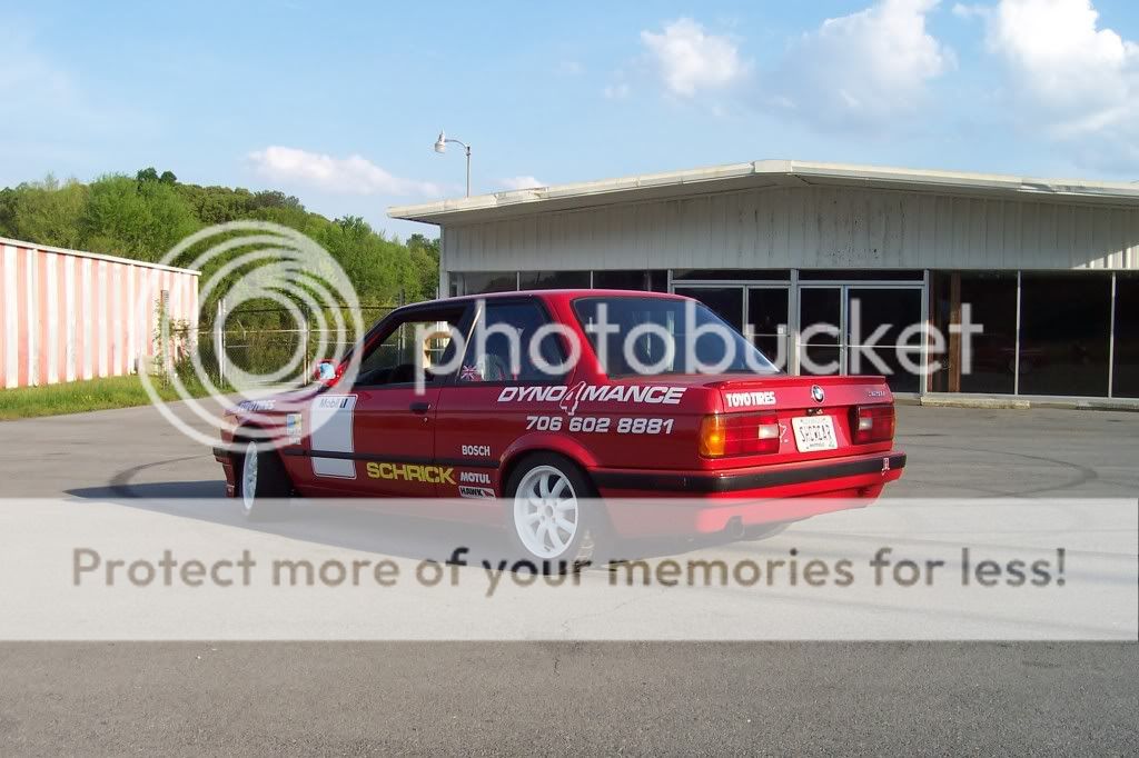

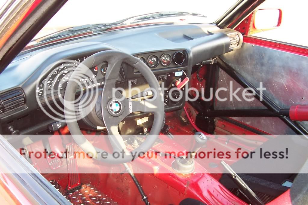

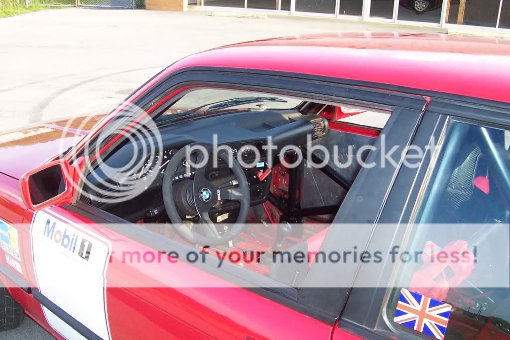

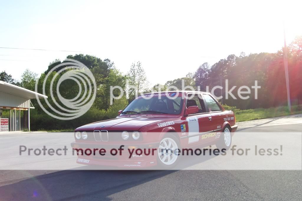

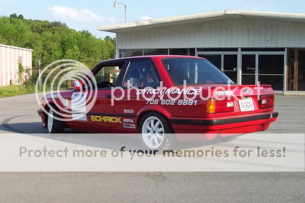

              A few more pics to bump thread and show recent progress
              Videos of tuning and dyno sessions to come.......

                            • Dave
                              E30 RAT
                              • 11675
                              #119
                              like the number panel
