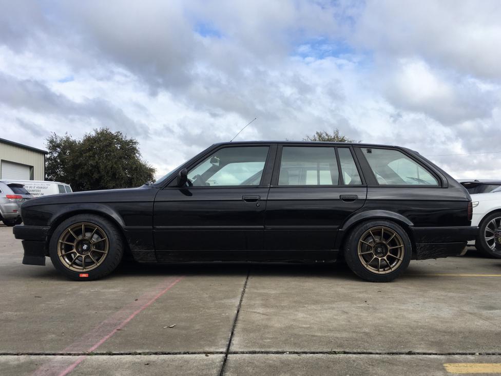

        Just a small update. I decided on ground controls coilover conversion kit with adjustable camber plates. I also condor speed shops rear adjustable camber bushings and 3.64 LSD the car is a different car now!Click image for larger version  Name:	IMG_2433.jpg Views:	0 Size:	82.1 KB ID:	9911237

        • Shangsta
          • 1485
          what is the wheel tire setup on the car?
          :shock:
          • moatilliatta
            • 6150
            Car looks fantastic!
            I think the ground controls with koni’s has the best value per buck than all the options. And they ride great also!
            When it comes down to it, the expensive stuff needs rebuilt every 30k miles or so... after comparing I’m ok with the reliability quirks of koni comparatively.
            And I thought I lost my lust for a wagon, looks great! The sparco wheels actually look good!
