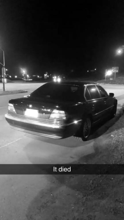

            Roughly 2 weeks and 748.3 miles later, the regret has arrived. Driving home last night, behind 2 other cars in my neighborhood, I noticed that they had suddenly slammed their brakes and came to a stop so I obviously followed suit. (A tree had fallen in our lane). As soon as I came to a stop, my idle started to drop and fluctuate and I immediately got the "STOP! ENGINE OIL PRESSURE!" readout on my cluster. Seeing as I was only 2 blocks from my house, I slowly accelerated up to ~20mph, (very uncomfortably and with noises that should never come from a vehicle), and then shut the car off and coasted it home in neutral. It's been raining off and on all day here today so I didn't even go out and pop the hood to examine anything except the oil level, (which is perfectly fine), but after doing some reading, apparently on M62's, very hard braking can move the oil pump if one of the 3 bolts that holds it in place is loose but if one actually fell out, it's somewhere in my motor now. It honestly sounded like the motor had zero oil in it. From what I've seen today on YouTube, it sounds like timing chain guide failure but my TCG's were done only 9k miles ago at 162k. Now my issue is, a timing chain guide kit is ~$1500 and everywhere charges between 22 and 30 hours of labor for the job and I own none of the special tools needed to do the job, nor would I be comfortable attempting it after seeing the DIY write-ups on it. So I either find another non-TU M62 and potentially a 6 speed out of an E39 and do the swap or bite the bullet and fix my current situation for the same price of a new engine. I miss my Miata, I miss E30's, I miss my Jeep but I still really like the E38. Even as a lawn ornament.

                I'm at 172k with full records and everything from the original owner and this, of all things, is what ruined it lol. I'm gonna pull some things apart on Tuesday and do some further examination and I'll update here.

                  Shitty situation, I suggest pulling the motor to inspect it closer. Then find an E30 to put it in

                      holy shit man that sucks. I'm with 2man on this one. Swaparooskie...

                          E38 update -
                          Oil is fine, oil pump is fine, car is running with no oil pressure issues, misfire, or CEL but it is still making an awful noise, (I'll try to upload a video and post it here.) Sounds like bad timing chain guides to me, any idea how long the motor can run with bad guides?
                          These video's were the 1st and 2nd starts today and I actually let the car just idle and recirculate the oil as much as possible. Oil is clean, no metal or anything in it, gaskets are all good. I'm assuming that the hard braking actually just sloshed the oil so hard that it lost pressure and it just needed to recirculate. The noise is however still concerning but the noise in the videos is much quieter now, but it isn't gone. Counting down to actual engine failure, saving money for M62/420G swap.

                            Update - it'll last about 13 miles lol.

                              Aww jeez. Hopefully you invested in cybercurrency before that 13 mile drive otherwise I don't see how you could have saved enough for a manual swap in that much time lol
                                That blows. At least you got an artsy B&W snap out of it!
