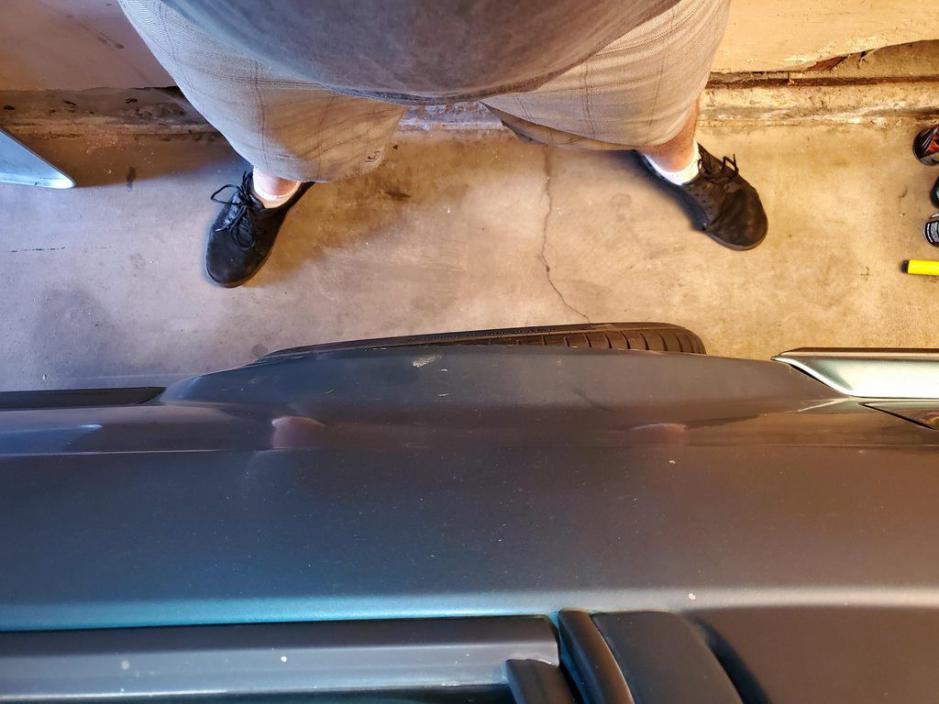

        Does anyone have access to an alignment machine where I could get a few measurements? I've installed rear toe and camber adjusters, but at the max toe-out adjustment I still have an obscene amount of tow-in. I tried measuring it using jack stands, string, and a laser measure, but my calculation ends up with only 0.5 deg toe-in. Based on the picture below (and Inventor), I'm guessing that I have roughly 1.76 deg of toe-in.
        I'd like to measure it as it is, then adjust to full toe-in. This should give me my full range of motion, allowing me to calculate where the adjusters should be welded.
