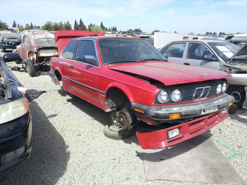

        what body kit is this??

          an ugly one imo..zender
          don't understand how some can dig em

              i would take them if I were you. it's cheap to buy at PnP. is that the Sac one?
