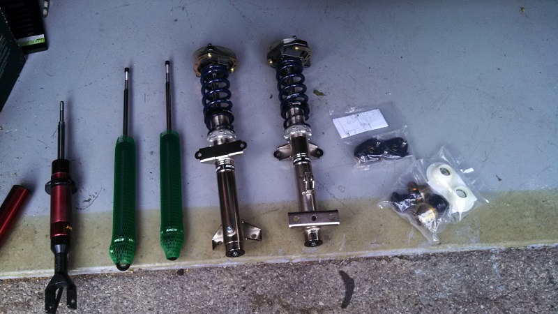

            Scored some hardware today!
              Noice. :bow:
