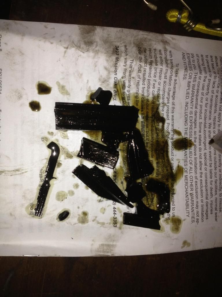

              so got the oil pan off and found this
              The remains of the driver side chain guide. No wonder I could hear a metallic clicking sound! I thought it was the lifters at first but obviously not.

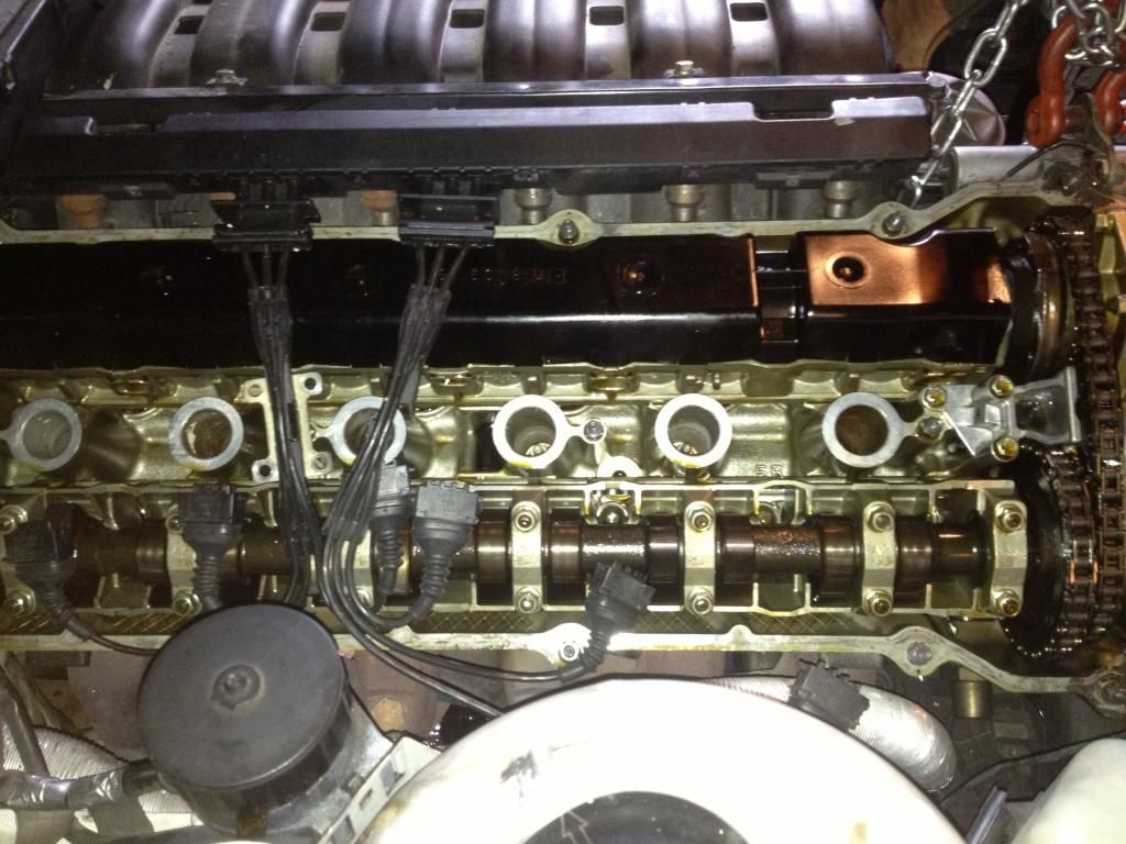

              I proceeded to panic about the top end and ripped the valve cover off
              Thankfully everything up here looks excellent. Extremely clean and the chains aren't worn at all.
              So from what was FUCK OIL PUMP NUT is now basically a front end refresh including water pump, chain guides, gaskets, and whatever else I feel like doing while I'm in there. Probably better to just get it all done anyway.
              Also going to pull the entire front sub frame, do a bit of welding that needs to be done. CLEAN the shit out of everything. Winter break project status has been achieved weeeee good times.

                Have fun, that's an awful job. To do it properly, you have to pull the head and the oil pan.

                  You have to pull the head?
                  I thought you could get away with just pulling the front timing cover?

                    You can, but to do it properly, you might as well just pull the head. Gotta make sure there's nothing jamming up your oil galleys or anything. Good time to do a valve job and vanos.

                      It's pretty much impossible to put the timing cover back on. and you can't replace that driver's side guide with the head on anyways, there isn't room.
                      Also, use heat on the crank bolt. It is extremely tight from the factory (for good reason.)

                        You can put the timing cover back on if you have the oil pan off, but like you said, that doesn't help with the driver's side guide.
                        Make sure to get a new crank bolt, and put it back on as tight as possible, and then some.

                            I'm going to do a compression check and if everything is fine avoid pulling the head.
                            From consulting the bentley manual it doesn't say anything about pulling the head so I'd like to keep it that way if possible.
                            The guy I bought it from mentioned something about the head being done not long ago and from how clean it is I wouldn't doubt it. It seems someone forgot the clip that holds the timing guide on so it came loose and shattered... by the looks of the other guides not being too worn at all I'm not sure how else it could have happened.
                            I'm obviously going to replace all of the guides and the chains while I'm at it. I like doing this kind of stuff... makes me confident my engine isn't going to blow up when pushed hard :D
