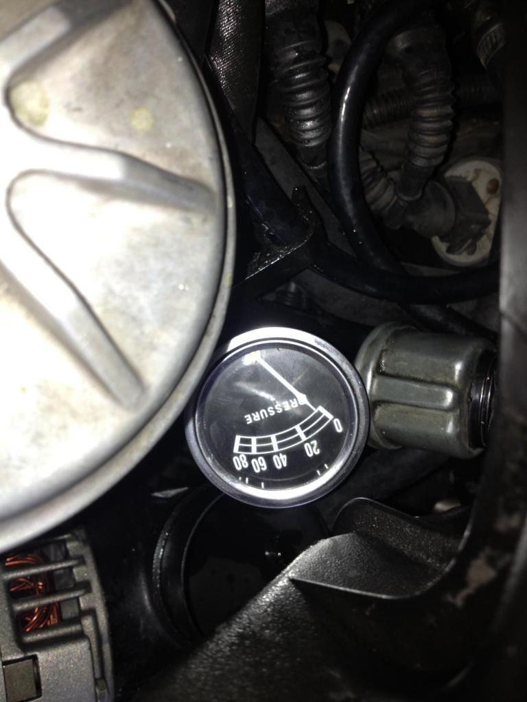

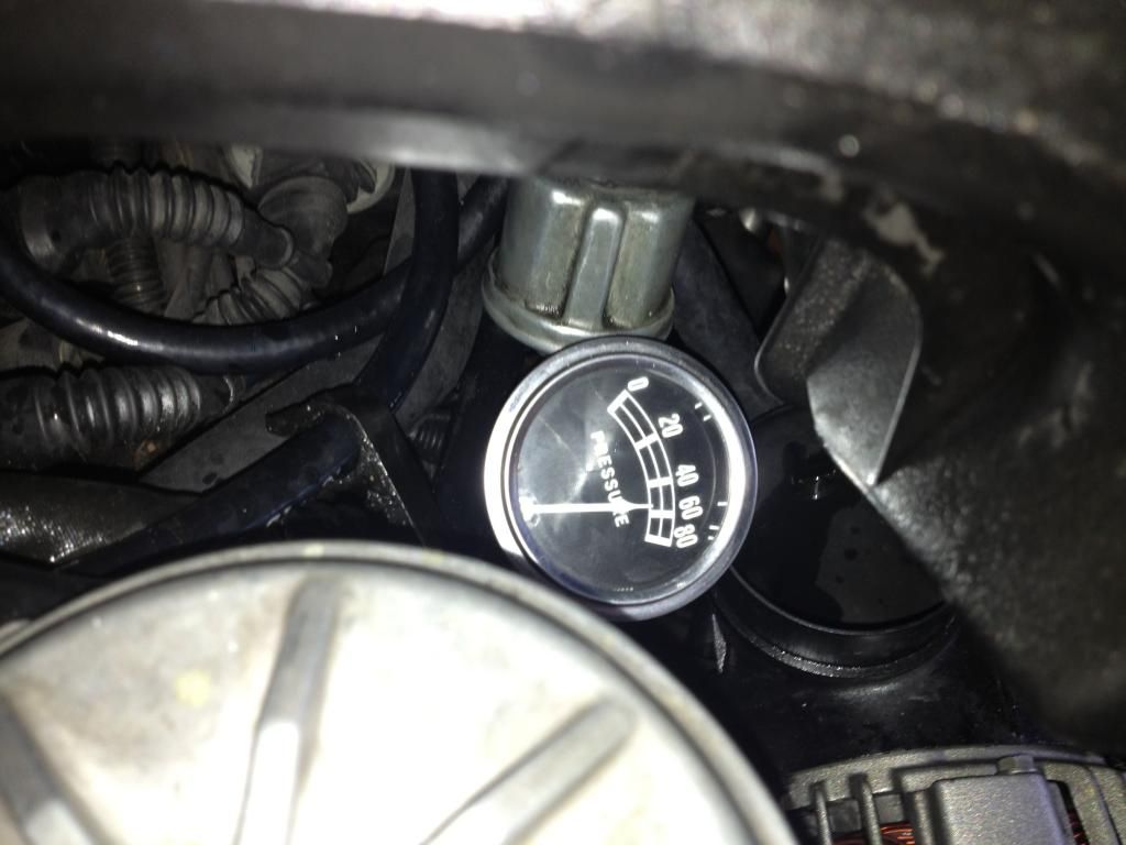

            so after doing some research i found that the electric oil pressure gauge i have causes the oil light to stay on regardless of if the pressure is what it should be.
            got a mechanical gauge on it and these were the results..
            idle
            at about 2,800 rpm
            the car does seem to be idling a bit low because the intake elbow is cracked and is causing a vacuum leak.
            everything looks good to me... pressure shoots right up with any application of throttle.
            what do you guys think?

              I generally see 8-12 psi at hot idle at 650-700rpm in a M50 family VANOS motor. At least 25 psi by 2000rpm when everything is hot.
              Yours seems a little low at idle... But the running pressure looks fine.

                i put a smaller scale gauge on and was getting around 15 psi at idle so i definitely don't think oil pressure is an issue.
