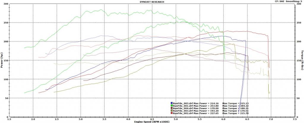

    Here's a consolidated plot of all the cars that ran:
    The cars are Tom's m30 (max hp:170); Martin's turbo m30 (253hp) , Jason's m50 with s50 cams(193hp. He discovered a fuel issue that was preventing full-power), Steve's M54 OBD1 (214hp) , and Joe's S50 w/ PS delete & 3.5" MAF (227hp)
    Here's a plot of just the S50 vs the M54. Joe's S50 was running lean and will gain some power with better tuning. The M54 was dragging an X5 power steering pump.

    that looks like a big issue! your AFR is crazy lean , you will damage your motor if you run it like that for long. should be sweet when its fixed tho

    This was fun. Thanks for putting it together. I found out I have some kind of issue around 6200 rpms as you can see from the graph. He said if I could figure that out I'd be just over 200whp probably.
    M50 with s50 cams, TMS under drive pulleys, 3.5" HFM, pink top 21.5 injectors, TRM chip, Raceland headers and e36 UUC System U exhaust.
