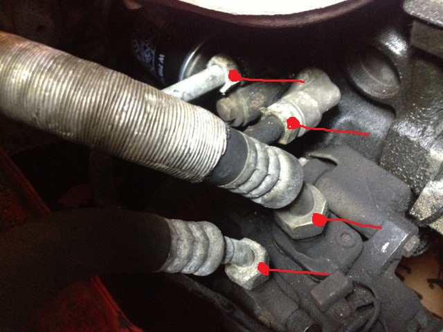

Almost pulled the m20 today, first time doing something like this.. and its all pretty straight forward, i didnt have the right wrench size.... so i could finish everythin was closed when i stumbled upon it... the last step before i loosen un do the mounts is the a/c anyone know what the size wrench i need so i dont go guess and check at the store in the am? they are marked in the picture.

The top 2 are oil cooler lines.Almost pulled the m20 today, first time doing something like this.. and its all pretty straight forward, i didnt have the right wrench size.... so i could finish everythin was closed when i stumbled upon it... the last step before i loosen un do the mounts is the a/c anyone know what the size wrench i need so i dont go guess and check at the store in the am? they are marked in the picture."We praise or find fault, depending on which of the two provides more opportunity for our powers of judgement to shine."Comment

To remove the oil cooler just loosen the bolt that is between them. Its a 17mm. The ac lines are 22mm and 19mm iirc-Andy
Oh you can just take that one bolt out? Ok that will be easier. And thanks so much... Ya mine stop at 17:(sigpic

If you dont have this knocked out in the next couple days I could swing by on my way home from Centralia and give you a quick hand. Pulling an m20 should only take an hour or so. For me any way. They get easier after you pull a couple.-Andy
