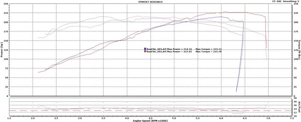

      Here's how the M54 compares to the S50:
