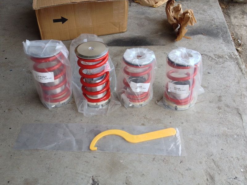

Now for my cheap ass coilovers! Bought these cosmo coilovers from a forum member brand new for cheaper than new! And then sold my h&r sports for half of what I paid for these, so I lowered my car for crazy cheap money. I kept the bilsteins in there, it’s a good combo IMO. And dirt dirt cheap. Might need stiffer rear springs eventually, I get crazy rub with the new wheels and that turbo action (later).
