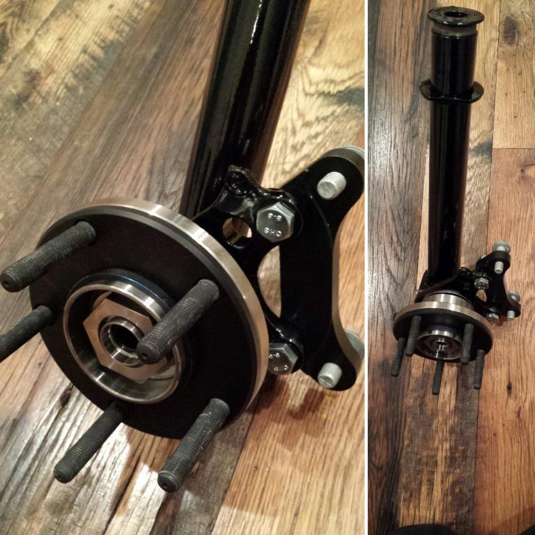

The rear of the kit bolts on, so it can simply be unbolted when parts need to be replaced. I actually way over torqued the hub nut for the front on one side when I was installing it. It smashed the front wheel bearing so I had to pull the whole thing off. Overlooking the added frustration of having to take apart what I just put together, I learned it can be taken apart. I did have to use a bearing puller to pull it back apart, but its the same as replacing a normal wheel bearing with basically a spacer in the wheel bearing to take out. Just don't throw the machined part away! I was able to reassemble with the same parts I tried to install the first time.

Let me know if that didn't answer your question. But really I "replaced" a front wheel bearing with the kit, just unfortunately the wheel bearing had 0 miles on it :(
