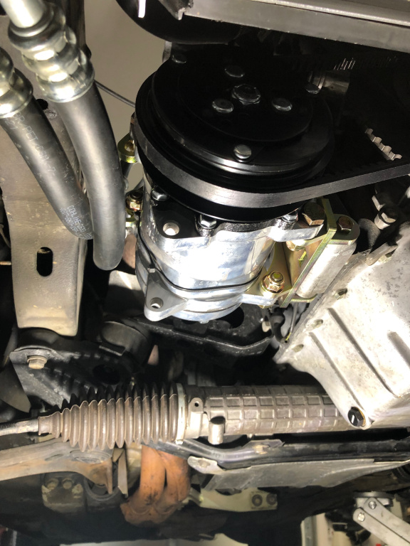

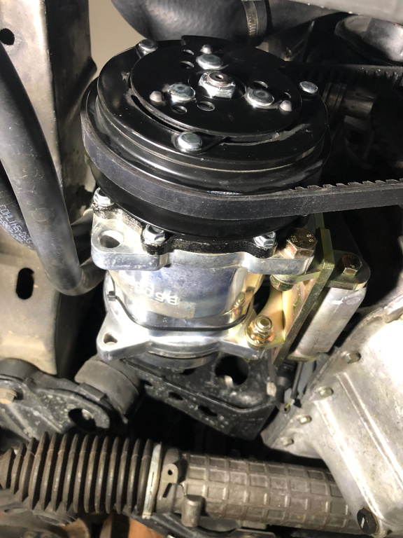

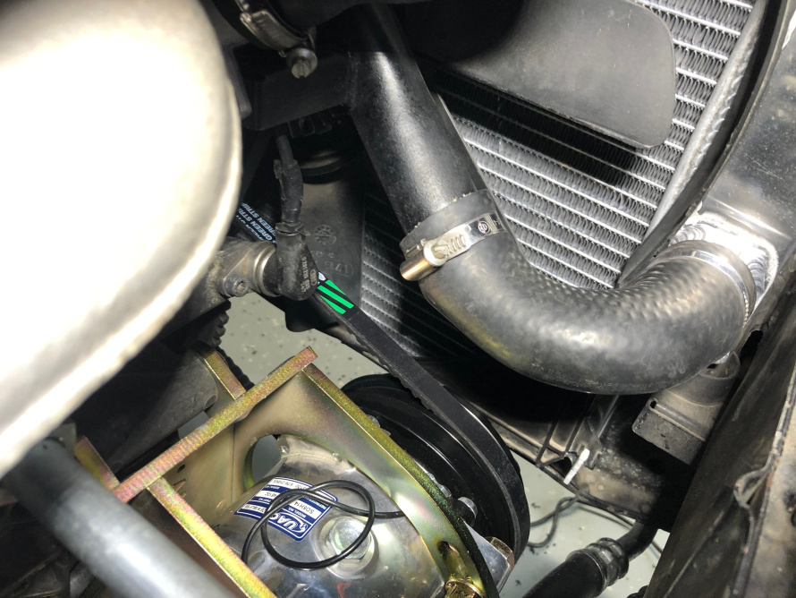

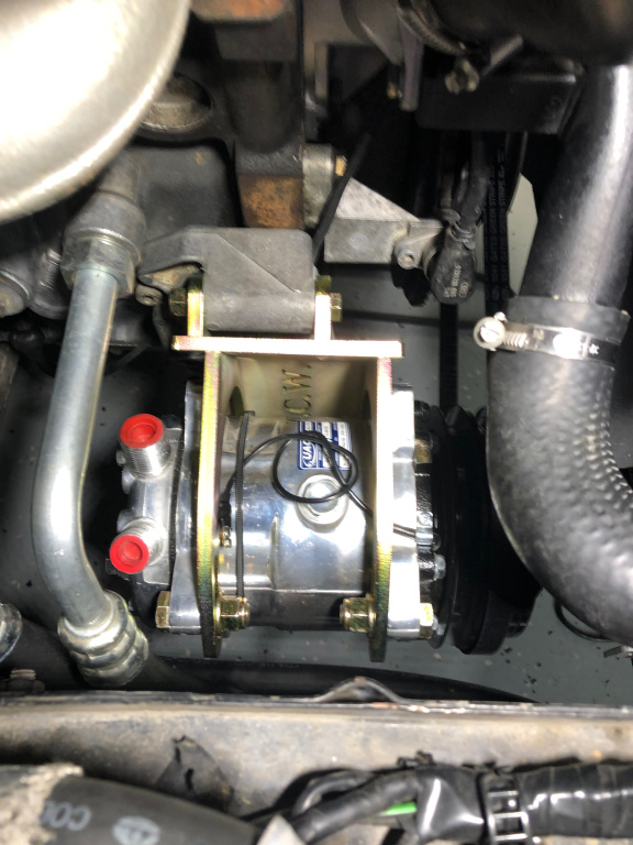

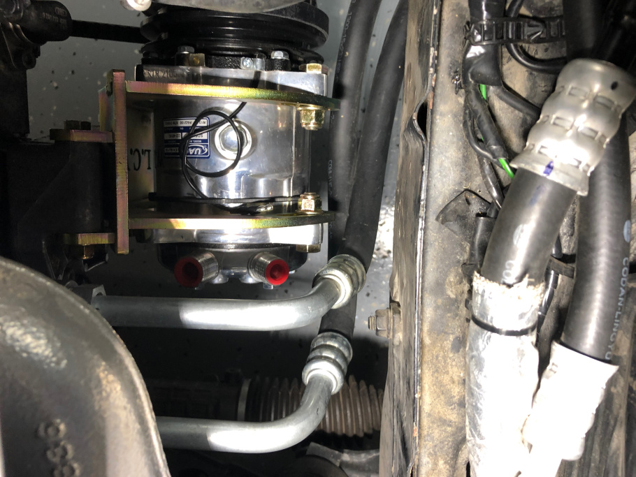

                    I have the Wylie bracket and r-134a compressor. I don't remember what model off the top of my head. I had the bracket zinc plated gold to match the other engine bay stuff. I will be getting rid of the compressor, bracket and belt if your interested. I will keep the hoses to have them remade for my swap project. Here are some pics right after install, but before I had hoses adapted to fit. I can post a picture of those later, if you want.
ID:	10103450 Click image for larger version
ID:	10103451 Click image for larger version
ID:	10103452 Click image for larger version
