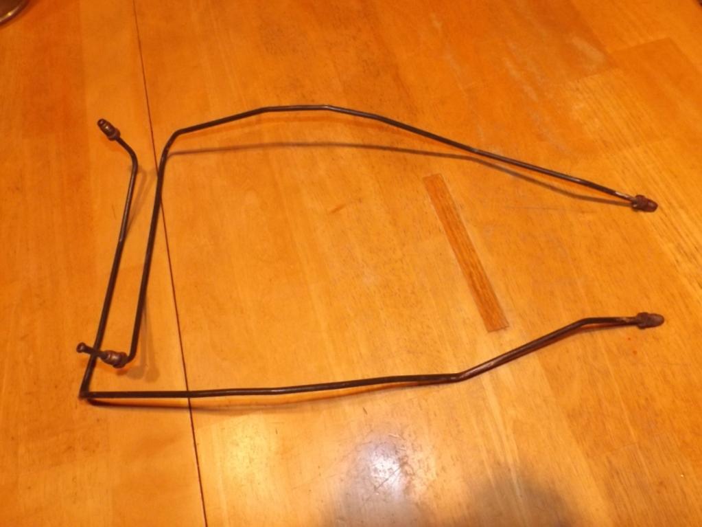

      these?

                I think these are it. PMd you.
                          Looking for these please anybody???? Been long time now :(
                          Bought these from Vpilarrt ^^ and apparently they got lost in the mail by the way, good guy and a great seller.
