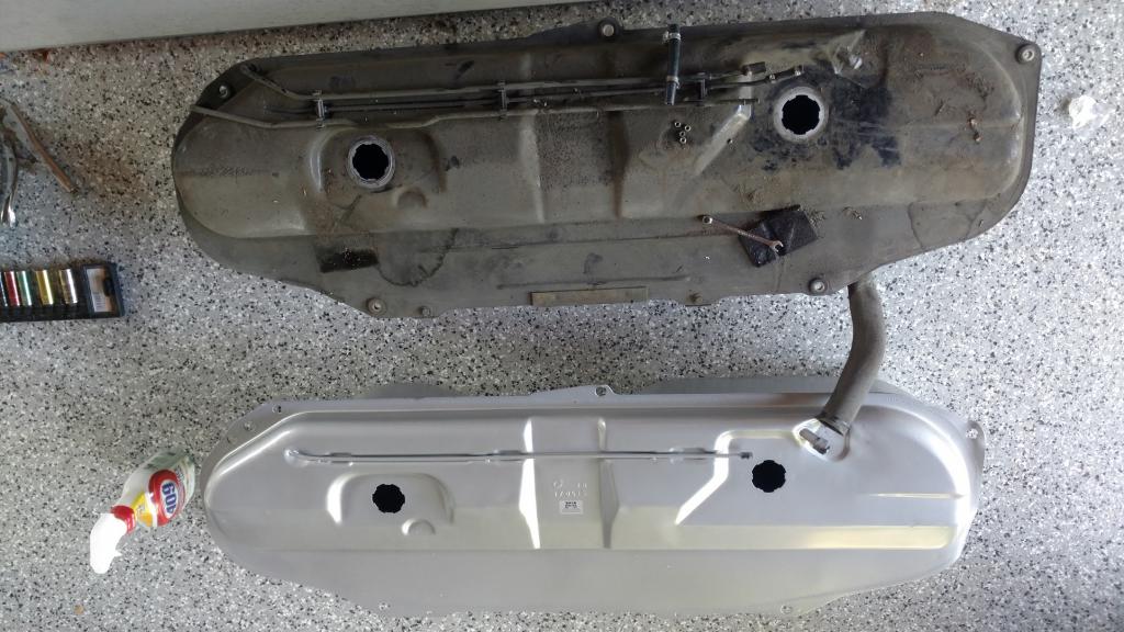

                            I dont think you need to undercoat it, since I am cleaning up my car as I put in subframe front and rear etc I decided to undercoat to make it all match.
                            • Staszek
                              • 2533
                              Just an update this tank fit almost perfect. Its definitely worth $200 vs the OEM $1200.
                              The front middle bolt hole is slightly off so I could not use the metal insert. I may drill it over a bit in the future so I can use it but with the rubber grommet in there (and a washer) plus the other 4 in their perfectly I am not too worried about it.
