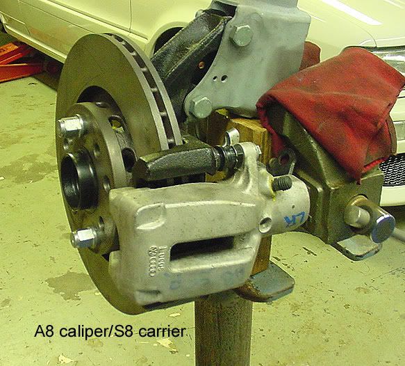

    The one-piece and two-piece kits have the same specs, except for th rotors. Clearances are similar.

        One obvious design improvement of the two-piece kit over a one-piece rotor that I completely forgot to mention is that whatever the supplier, except for the RacingBrake unit, they all come with the vent openings toward the outside, which keeps us from using air ducting, and many of the rotors come with slots all around the hat, which is claimed to be prone to cracking when abused. So, basically, if the car is street driven, you may keep a one-piece disc. But if the kit is to be tracked with a hi-po motor, then perhaps it is a good idea to upgrade rotors too. ;-)
        Kurt did test the RB rotors to what I suspect was their limit, with very high friction race pads. Cracking did occure all around between the hat and the friction surface on the thinner area. Not a pretty sight. So, the RB discs are still great for light to medium duty. Not so for very heavy duty. Pardon my honesty for disclosing what some people will judge as a flaw, but that I 'd rather present as a practical test at the upper limit of duty. ;-)

                    The creeking is most likely brake dust trapped behid the stainless steel strips on which the pads slide. They have a slight spring effect and there's room between the strips and the caliper's body. Usually, a bit of compressed air will "do the job".
