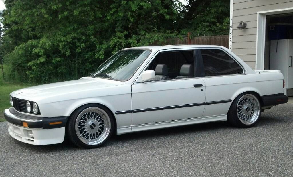

        I'll post pics of mine for an example for ya Nigel.
        My early model as it sits with the GE setup.
        Front - 5" springs w/sleeves flipped 1/2" of adjustment to go, IE race camber plates, Billy sports.
        Rear standard GE rear coils, no adjusters, Billy Sports.
        Was originally running 6" fronts with sleeves flipped. Will eventually go back to them when I shorten my housings.

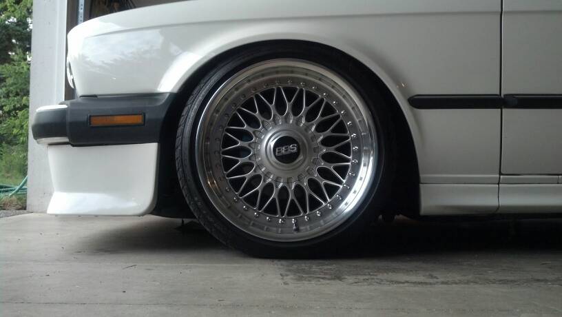

            does anyone know how much more clearence is gained for offset by removing most of the oem front spring perches?
            • einstein57
              • Jun 2007
              • 10780
              #111
              If your running proper or undersized tires then 0. Typically you can see the tire at or below the factory weld.

                            • e30experiment
                              • May 2013
                              • 132
                              #119
                              my bad your right. my car isn't as low as i expected with these in the front.
