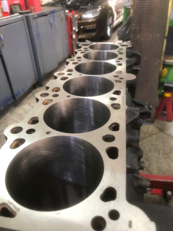

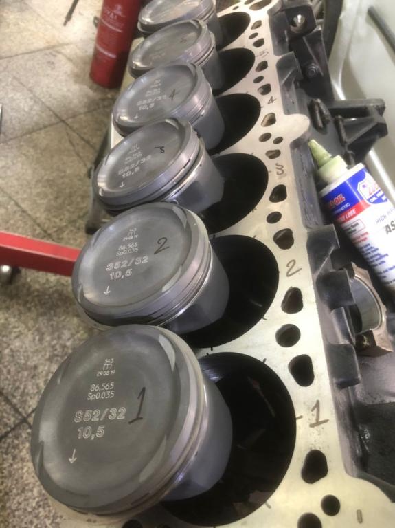

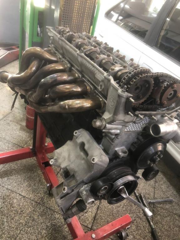

    Hello guys,
    I have built a S52 clone using M50 block, m54 crank and rods, S52 pistons and S52 cams. I dropped the engine into my E28 chassis and now i have problem with the engine not running right. I get the crankshaft and ICV fault. The dme is MS41 from a M52 and i already ordered the S52 dme. im using E36 harness which was made by redlinemotorsports to work with E28 chassis. I'm confused what sensor to order?? S52 sensor or M50 sensor or...takes awhile for the engine to fire up and the car not pilling as it should. I really appreciate any help.
