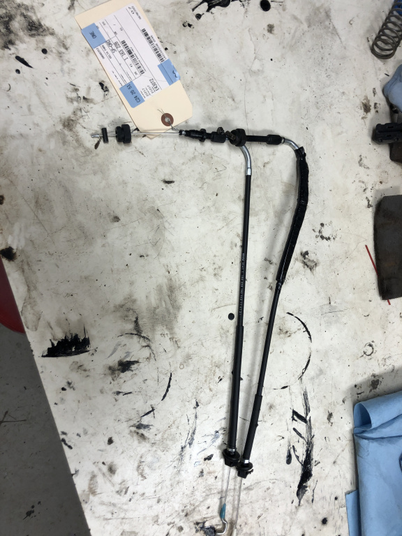

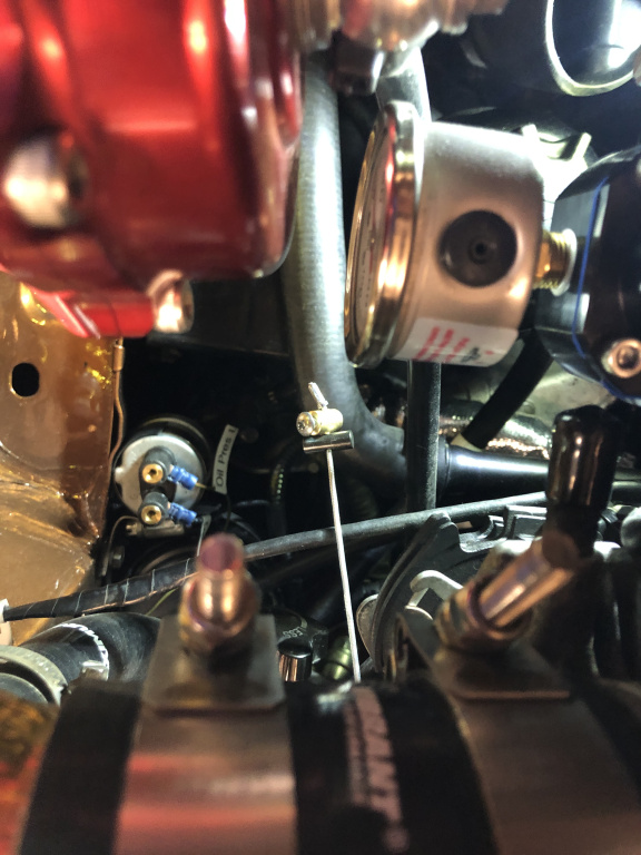

          Here is 35411163228 compared to my modified (shortened) cable. Almost the exact same length.
          Had to add an extra (aftermarket) cable stop to take up some of the slack at the throttle body. But otherwise works great!
