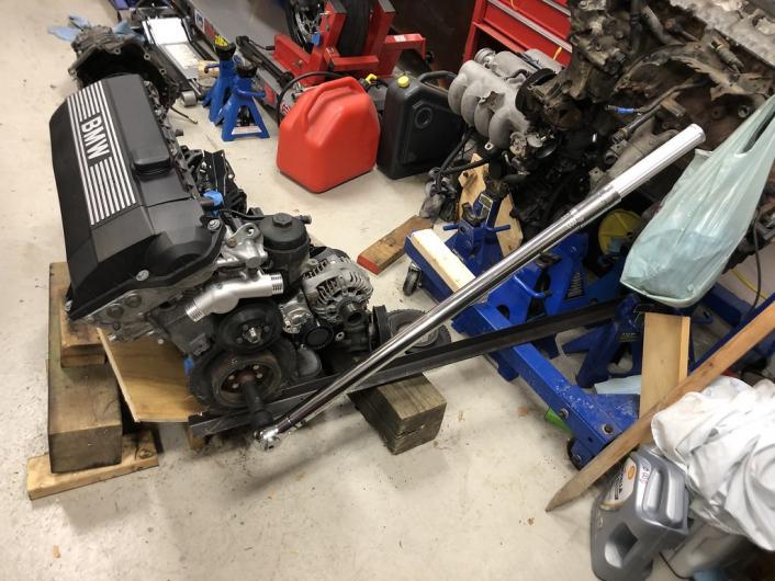

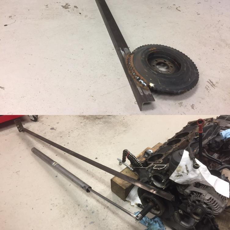

    You're going to need a 3/4" drive torque wrench. Crank bolt spec is ~300ft.lbs going from memory.
    I also made my own crank holding tool out of a spare pulley and piece of old bedframe.
    A friend won't help, what you need is a solid surface to brace the crank holding tool against.
    Click image for larger versionName:	51891503873_ce74a7c50f_b.jpgViews:	0Size:	70.5 KBID:	10061726
