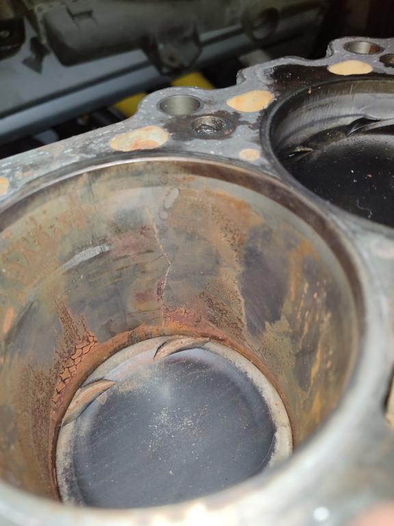

        Carnage pic for posterity. As you can see, it cracked vertical along the spot where the thin wall near the water passage meets the thicker cast, between the cylinders where the head bolt resides.
        Click image for larger version  Name:	IMG_20221115_150516.jpg Views:	0 Size:	51.8 KB ID:	10074533

              • ForcedFirebird
                • Feb 2007
                • 8300
                Just went to the engine room and took some quick measurements. Measured several through the water jacket with a caliper, this is not a sonic test.
                s50us 86mm bore 6.6mm avg wall thickness.
                m50nv 84mm bore 6.7mm avg wall thickness
                m52 84mm bore 7.4mm avg
                Don't have an s52, and didn't check an m50tu
                Cylinder that cracked is 5.8mm on that wall.
