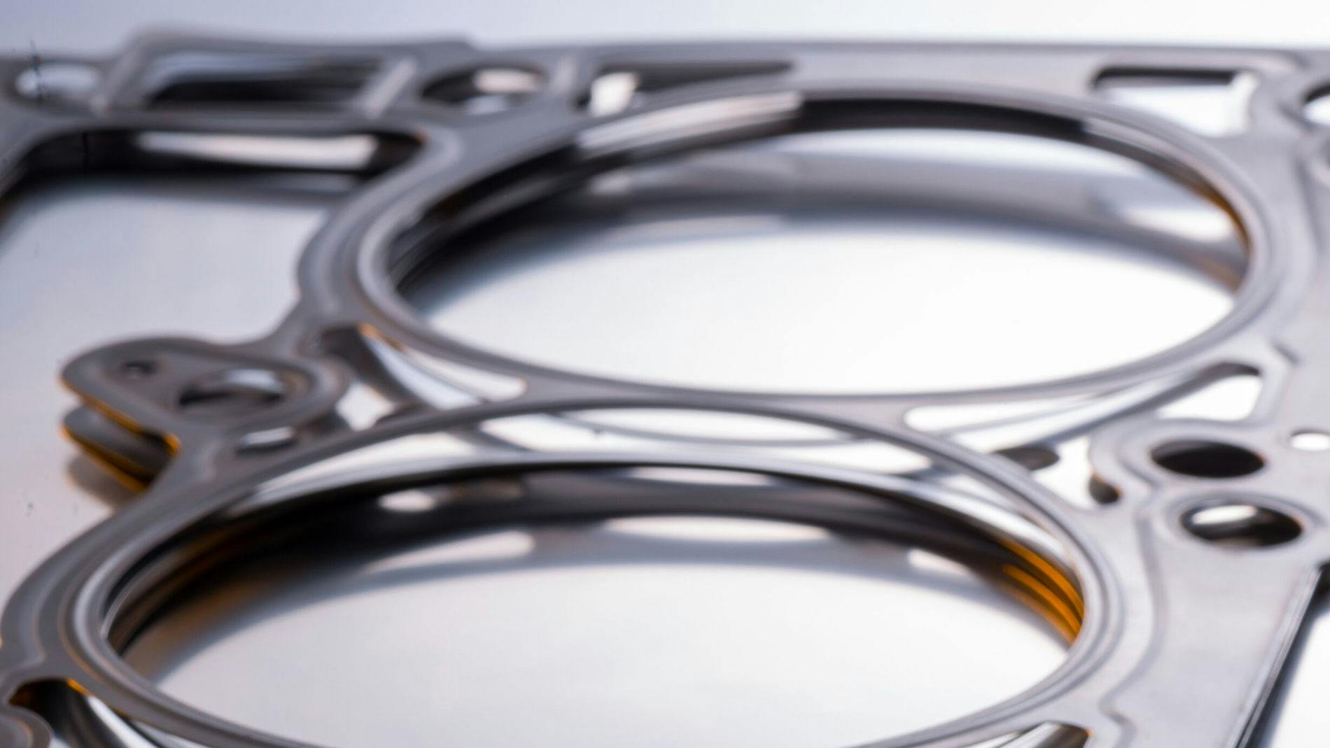

    To add, if your pistons are 1.2mm below the block deck, then you apply the 1.7mm head gasket, your pistons will theoretically be 2.9mm from the head surface.
    When building engines, I aim for .95mm.
    To test, put used head gasket, torque with used head bolts, attach cam drive, rotate engine, remove head, measure clay/solder.
    For example, when building "budget" m20 2.7l, I use 81mm crank, 135mm rods, stock m20b25 pistons, then shave the block 2mm to get the compression height back.
    I suggest your pistons be higher (or block deck lower).
