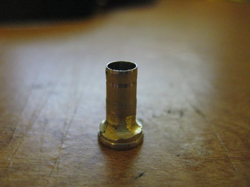

 The tool is made from a rg59 f connector.

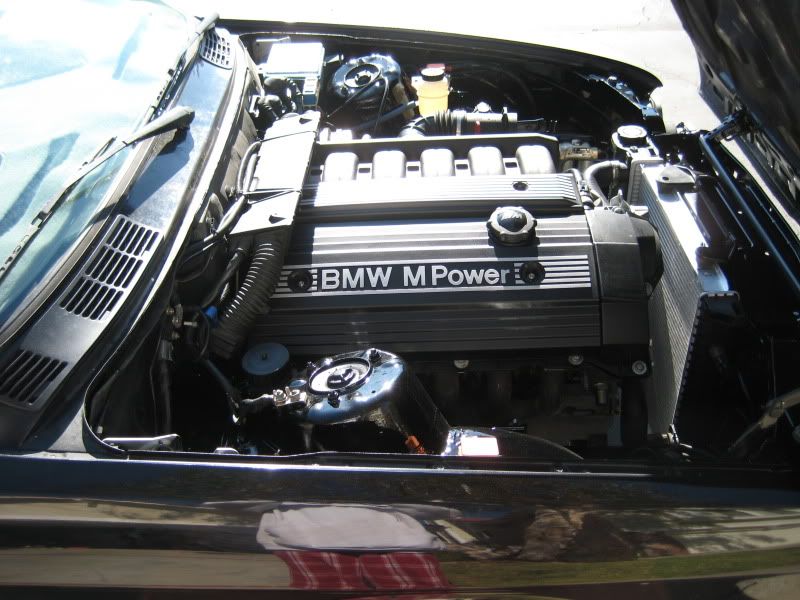

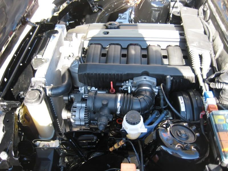

 Car was picked up this morning. Car runs great and I think everything is pretty clean. Pulls like a mule with the 3.73 in the back.
 Really loud with just the midpipes on but that's easily fixed. Actually got in trouble last night just letting it idle. Flushed the cooling system as much as I could for now. Still have some residual oil from the heater core due to the previous motor/owner overheating the car and it sitting for 4 years after. Couple of flushes should do the trick though in a later date. The m3/e36 intake boots seem to get in the way of the master cylinder, so I'll suggest to koole30 when he can to buy a e34 m50 intake boot to clear the master cylinder.
 Only known issue is the CEL light gives me a code 1281. Pretty sure it will go away with a quick reset. This car was far from running when I first set eyes on it. Took many hours of bending over to get it to where it is now.
