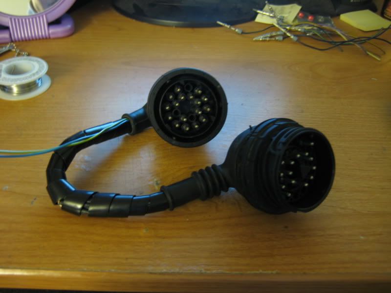

            Finished making koole30's wiring adapter. Looks x10 better than mine sadly enough.
            Tested it on my car. Works great, exact replica of mine from my car. Used a easy wrap to wrap the wires. Removed all unused pins and wires.

              Looks great man, nice work. Everything is nice and clean just the way I like it.
              Why didnt you wire the E30 C101 into the harness so it is direct plug and play? The pins are cheap at the dealer and you can buy the pin tool at radio shack.
              Just and FYI for your next swap.
                You mean this pin tool?
                I will eventually one day buy the pins from the dealer. Is 61-13-1-376-191 the actual part number?

                  I use these ones.
                  61-13-1-376-195 paid 8.80 for 10 of them.
                  61-31-1-376-193 paid 18.80 for 20 of them.
                  The c101 plug is like 4.00 or something and the boot is like 1.50

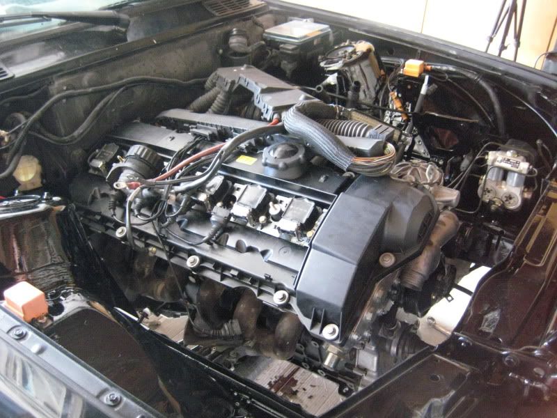

                        Alright quick update.
                        I got the motor and transmission bolted up, got the driveshaft and midpipes on o2 sensor in place, basically everything for the car to run except coolant related parts (radiator/hoses).
                        I tried to get it started but to no avail. I have power to the dme, power to the ignition coil plug when the key is turned to the on position but I am not getting spark. Tried to get the spark plug to spark but couldn't (grounded the thread portion of the spark plug and place the spark plug in orientation as if it was in a car) and still no spark.
                        Things already checked:
                        506 DME works, tried it on my s52 e30.
                        CPS sensor reads at 550 ohms.
                        Made sure all grounds were making contact since the engine bay was painted
                        Power to DME through dme plug pin #56 at 11.9 volts
                        No power when cranking the motor to fuel pump connectors
                        No spark
                        Wiring adapter works as I checked it on my car
                        Spark plugs brand new
                        Coil plug boots in great condition
                        Sprayed starter fluid to try to see if it was fuel related but no go
                        Anyone else got any ideas?

                              #44
                              Guess no one wants to give a crack at it?
                              I have a theory. If my dme is getting power, and my plugs to the coils are getting 12v when the ignition is on, yet I'm not getting spark... Could it be that the harmonic dampner that is on koole30's car be from a non-vanos car? Is there really a difference between the teeth count on the harmonic dampner?
