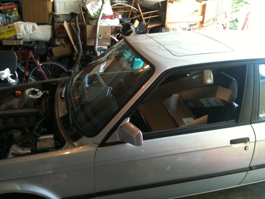

                          Hmmm....what's in my driver's seat?
                          Can I haz exhaust? :D

                            what was the power difference from a m42 to m50 ?
                            • ahriley91
                              • Jan 2010
                              • 451
                              #89
                              Very noticeable. I just got the thing legal on saturday. It took forever to get my exhaust all welded up. I had the 4.10 in it, drove it for a day. Then went out and got a 3.25. Way too high of gearing for my taste. I love it so far. Saving up for coilovers now!! How goes your swap? ^
