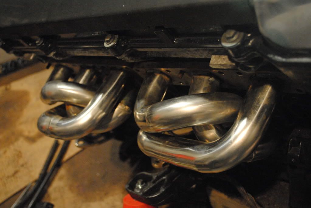

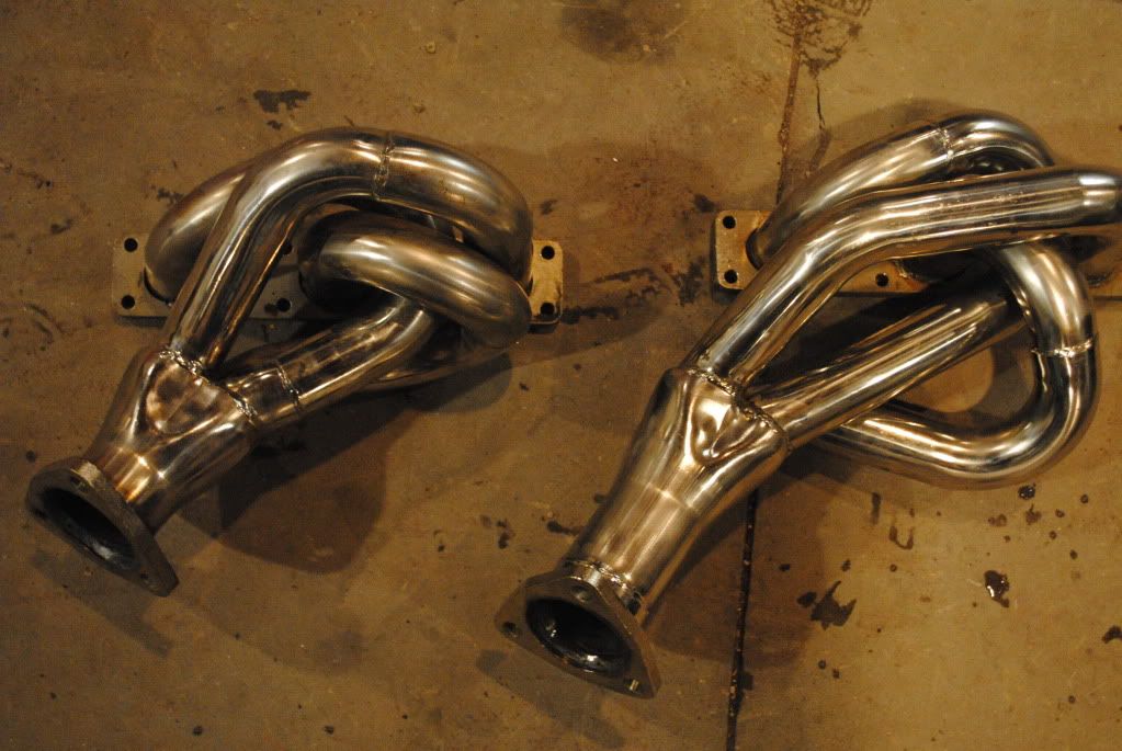

        ok so i got my headers today and the dont fit, the bolt wholes line up but on a few i can put the bolts through or put a nut on the end because the piping is in the way of them.

          Doesnt look to hard to me [pt the bolts threw first. Then put the headers on not all the way so you can start the threads.

            Wtf is up with the half bead weld in the last pic? Were they too lazy to weld a bead all the way around?

                    its welded on the inside and the parts that arent welded on the inside are welded on the outside, and i cant get the bolts through either way because the pipes actually cover the wholes so i cant even put a nut on them.

                      #55
                      This is what I was thinking when I saw those. They look cool but they look like a PITA to install. I removed and installed two different headers on my engine while it was in the car and that was a pain even on nicely spaced pipes. Maybe shorten your exhaust studs?
