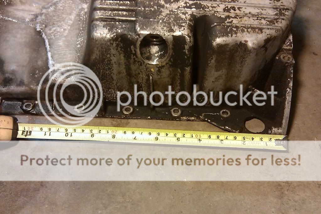

                        It seems that the sump area on the E36 pans is too big and I will need to use an S54 pan. Is the S54 pan a direct swap over? I thought it was a dual pump pan or something like that.
                        S54
                        E36
                        • Wanganstyle

                          In 1995 in our USA, BMW sold the S54 oil pan with M3 Lightweight edition cars. It was included in the trunk with some other cool items (ltw spoiler). S50b32 (3.2 euro e36m engine) uses the same oil pan as S54. S50 GT versions (late 1994/5 euro) also came with this cool oil pan.
                          It has 3 pick ups instead of 1, also higher capacity; that is the main difference.
                          oil pan has nothing to do with brake booster. sorry
                          dipstick is matched to oil pan.
                          s54 oil pan is commonly installed on track s52's in e36'm.
                          s54 oil pan is designed to fit perfectly in place of s52 pan. the extra capacity sticks out on the left (usa driver) side.
                          only thing different when installing a S54 or S50b32 (uses same pan as s54) into rear sump car is that the steering rack needs to be dropped to clear the sump on install.
                          reference my e36m with S54 catless headers + oem e46m mipipes 1+2 x brace + no modifications.
