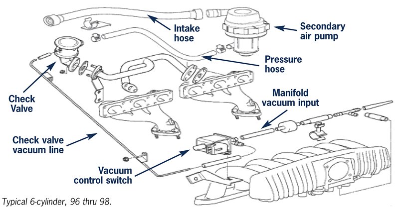

                              Starting my OBD2 conversion (99 S52). Got a couple of questions regarding BAR requirements. When I got the engine I did not get any of the SAP stuff. So I don't know what I am missing yet and totally lost in this area. Hopefully that is the right diagram.
                              1- The TB has two inlets for coolant hoses, one coming from the head and the other from the metal pipe. Since I will remove the one attached at the head for the temp switch, is it ok to put a T on the other hose and feed both inlets to the TB?
                              2- Keep the Secondary air injection pump and SAP from the S52 all the way to the intake manifold (Pump, electronic switch and valve). Just the way it comes on the s52.
                              3- Where does the intake hose (suction hose per realoem) goes. Don't see any inlets in the intake manifold.
