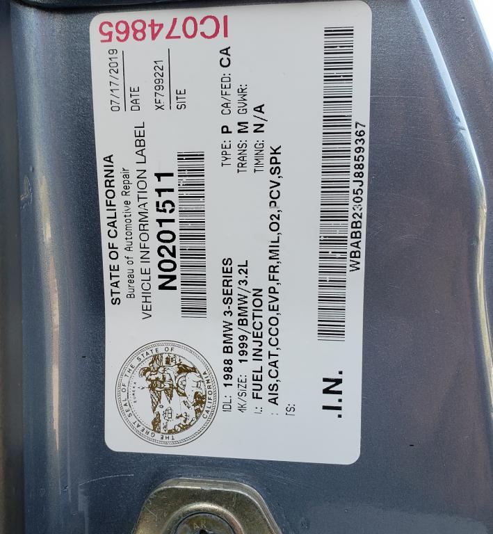

        I went back to the ref today… and left with a sticker! Notes from the second time around:
        - I was failing before for very high HC and slightly over max NOX.
        - Since the last time, I replaced the cats with new Walker CalCats, cleaned the MAF, and replaced the plugs.
        - I still was close to the max on HC (78/93)
        - The referee was the same one who inspected the car previously. Since nothing changed, the visual inspection went a lot faster, but he did check.
        - I ran the car HARD before I showed up (multiple high RPM pulls), and he put it on the rollers pretty soon after my arrival. I think this was a contributing factor last time, since the car sat for 30+ minutes while they got set up. This time it was more like 20, and most of that time it was idling.
        - They install the sticker in a permanent location on the body. He originally went for the engine bay, but I preferred the passenger's door jamb, so he obliged.
        Next I need to get plates, but the hard part is done! Super relieved this process is over with.

                  Well, technically, I passed ... But even after supplying the title to the donor car and showing the inspector that the VINs all match, I still have to go get a letter from a BMW dealership stating that the ECU has not been altered.
                  So close, but no BAR sticker!

                    Finally!
