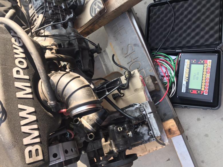

    M70 with all accessories, without harness and injectors, with 4HP24 transmission: 322kg/708.4lb
    M70 with all accessories, without harness and injectors, with flex plate, with starter: 234.8kg/ 516.6lb
    Weighed with my Chinese hanging scale.

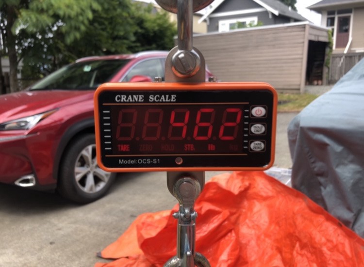

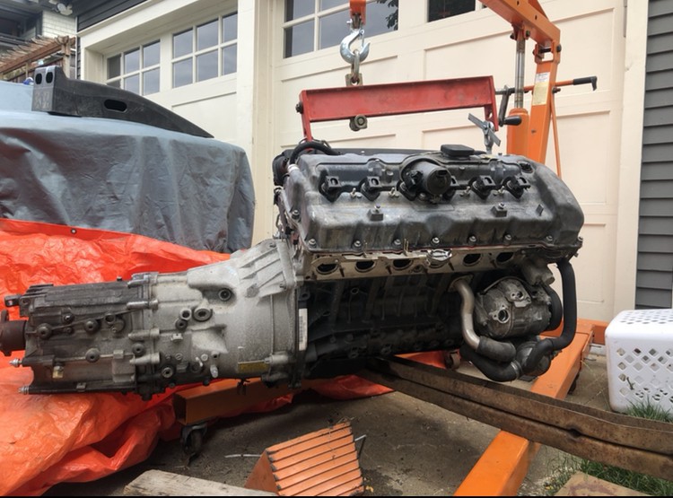

            It looks like the N52 weight here is pretty accurate. I think it is probably a euro engine, with no CATs or AC. 340lbs is probably with A/C and CATs.
            From the N52 swap thread:
            The EKT says the GS6-37BZ weighs 99lbs. The pressure plate is 16lbs, the clutch is 2.4 and the fork is 1.7. the dual mass flywheel is 22.7lbs. Put that all together (without fasteners) and you have 141.8lbs for the full 6 speed assembly (in your pic, there's no shifter, so I'm not counting that).
            The front manifold with cat is 10.8lbs, The rear is 8lbs. Call it 20 total (gaskets, bolts, etc). Aftermarket will probably be lighter, with no cats.
            So 462 + 20 - 141.8 = 340.2lbs, and that's with the AC compressor. Nice.
            I won't be running A/C,, so subtract another 12lbs for 328, fully dressed. That really closely matches the weight listed in this thread, 326lbs (must be without CATs and A/C)

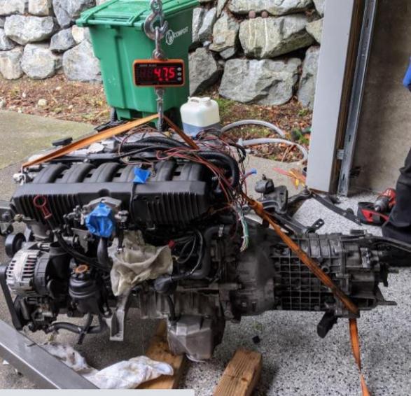

              458lbs. N52 with the lighter G6-17 transmission. No exhaust manifolds, no oil. WITH transmission and engine mounting arms and shifter console and the wiring harness.
