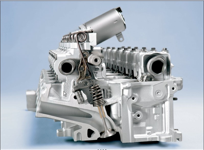

    Those ports are so sexy - very very awesome! Interesting that the fuel injector port is cast into the head - means that N52 intake manifolds can't be used on M50/M52 motors even with an adapter plate! :(
    He has some of the pictures upside-down compared to what you're used to; I think those are air passages for the idle circuit. Same port that's circled on my M54 pic.
    I was was also looking at the head design... no hydraulic lifters??
    Also, does this motor have a dipstick?

      When you look at pics of the N52 intake manifolds they dont seem to have injectors ports, at least not in the same position as the M50/M52 ones, they are either underneath or in the actual head of the car.

        I found a cutaway picture of an N52 head that shows exactly how the cam actuates the valves. It does have hydraulic lifters, but the lifter isn't directly over the valve stem like we're used to, it becomes the fulcrum on the other end of the rocker arm. Its mass doesn't move with the valve, it's stationary which is pretty cool. It has a 7000 rpm redline.
        N52's are known to have oiling issues with the lifters up until about 2008, the lifters get a lot of air and the motors are known for ticking.
