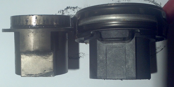

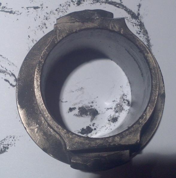

            I shoudl say...and it appears to make more of a difference...that I did it with the Bimmerworld aluminum throwout bearing and not a stock one. See pic 1 (tob1)....the left one is the Bimmerworld piece, the right one is a stock E46 M3 one. You can see the steps on the part and how much it differs from 90 degrees out. The E46 piece has the same step off but not nearly as great. In the 2nd pic you can see that the diameter is identical if you install it 90 degrees out but the flats aren't on the 90 degree out side so the throwout bearing will have more radial play in the fork. Not paying attention to when I put it in caused the problem, but it CAN go in easily without forcing it. The net result is a clutch that won't disengage.
            Looks like the tranny will have to come out to solve the issue and the throwout bearing is easily ruled in or ruled out...jsut something to consider.

              One dumbass to another (J/K), the e30/e36 TOB's have a round circle with two "cut-offs" unlike the pics posted. You would literally have to press the TOB in wrong.
              It seems like a simple solution to all this, it's standard procedure, day in and day out. Personally, can't even tell you how many transmissions have been on the floor this month, only one was auto in a '03 e46 in for an m54 engine replacement due to severe overheating, the rest were e30's with ZF's and/or G260/240.
              We all make mistakes, the only variable in this situation is the machined dual mass and fresh Sach's clutch kit, all the other parts worked perfectly prior to swap in the 97 m3.
                exactly and it would likely break before it got too far on the pivot shaft.
                It slides on easily when you install it with the slots all together, to MAKE it fit any other way takes some serious dumbass and effort like FF was pointing out. You have to try to be a fuck up to do it wrong.

                        What's the part # on the slave you're using? Did you personally slide the TOB on? I ask because you would see the shaft is flat on the sides to keep the TOB in the proper orientation. Lightening the DM flywheel is a terrible idea IMO. It's not the reason for the issues you have now, but it will be for the ones you have down the road.

                          I don't recall the PN...pretty sure it was an E36 325 slave. Yes I did put the TOB on...yes I see the flat sides after the fact, but it (Bimmerworld aluminum replacement part vs the stock plastic part) went on without issue.

                                The Bimmerworld TOB is included in the strapless PP setup. The body is aluminum vs plastic. When you plastic TOB explodes you'll see the logic. BTDT have the broken parts to prove it. Getting out all the ball bearings was more difficult then you'd expect. When you think you have the last one another one rolls around when you are trying to put the tranny back in.
