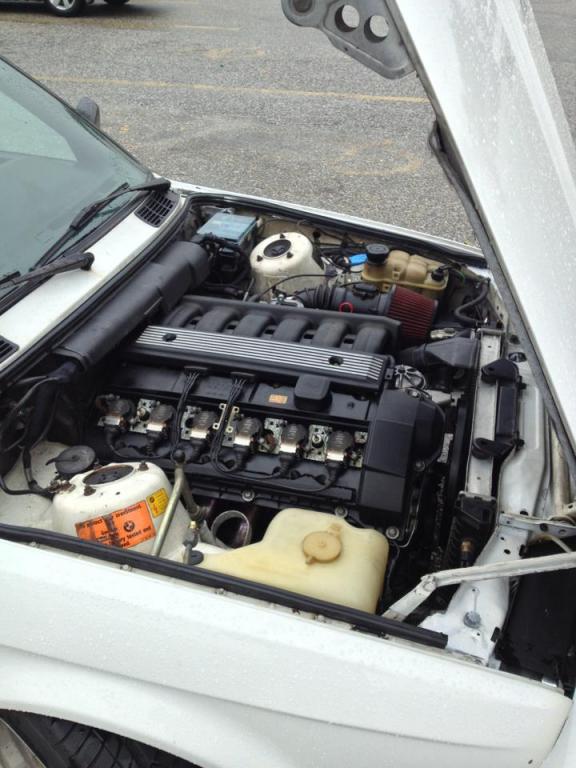

      528i M52 swap
      OBD1, M50 harness, stock 21.5 injectors and coils, 413 red label, chipless atm. 260getrag, stock clutch, shaved flywheel, stock drive shalf and diff.
      2002 brake booster, modified Shifter arm, dslr selector rod, Power steering with m3 rack and A/C connected, Audi fan with m10 clutch, stock e30 rad.
      Im very happy with the power that this motor delivers! :p

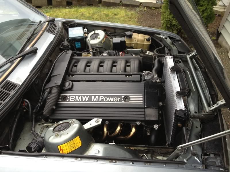

            #35
            Motor: '92 E36 M50NV
            Harness: E36 M50 Harness
            Injectors: stock?
            DME: 402 Red Label, I think chipless.
            Flywheel: M20 shaved down to 13lbs
            Clutch: M20B25 Sachs Clutch
            Driveshaft: E36 325i 5spd
            Transmission: Getrag 240
            Linkage: UUC SSK on Getrag 260 lever (sits about an inch forward from where it supposed to, but shifts great)
            Booster: 325iX (engine shimmed 1/8in driver side)
            Master: E32 master, 2002tii remote reservoir
            Radiator: '91 M42 Radiator
            Fan: Advanced Auto Electric pusher fan
            91 318i | 87 535iS
